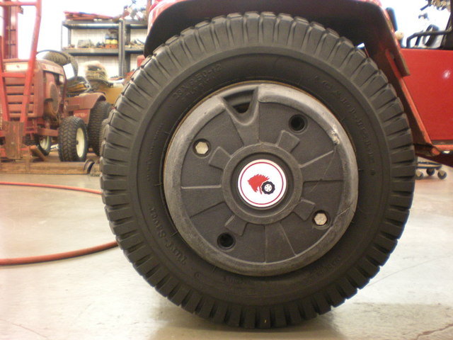

Sparky
I'm using these with 50# outside weights and 25# inside weights and no chains. I have a slight angle on my driveway and this combo works great!
The tires are 4 ply (and only come that way) but I have found that a 2 ply turf will give the best traction (keep the air pressure low).
They are 23 x 10.5's mounted on a pair of wide rims from a 520.

@Sparky, Where does one find weights like that? I'm very new to the addiction and would like to get a set like that before the snow fall this year?

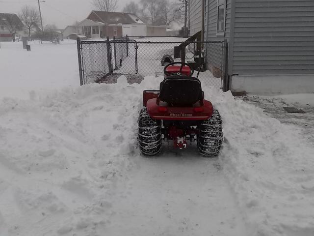

flyovrcntry
Whatever tires you use will probably require chains unless you have a flat area, and then you will need a lot of weight if not chains.

Sparky's weights are Farmall Cub front/ Cub Cadet rear weights. I fill my tires for winter duty with RV antifreeze along with weights and chains

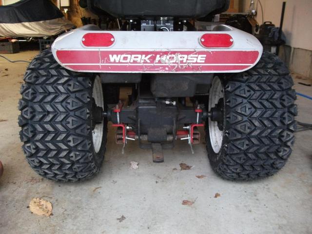

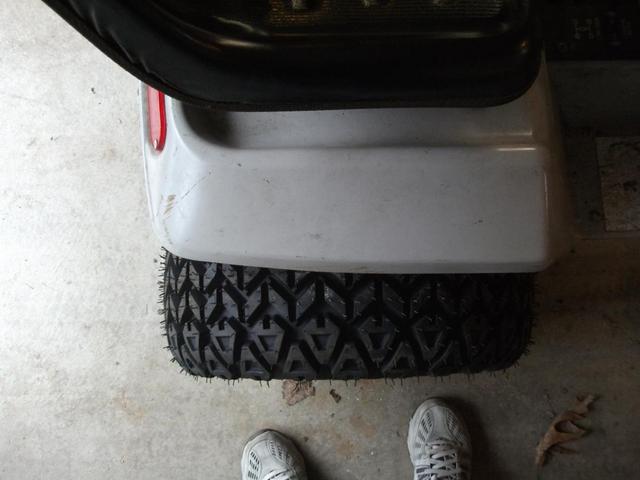

nhunt308
I can push 8+ inches with these
With no problem at all

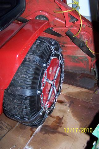

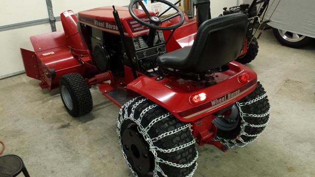

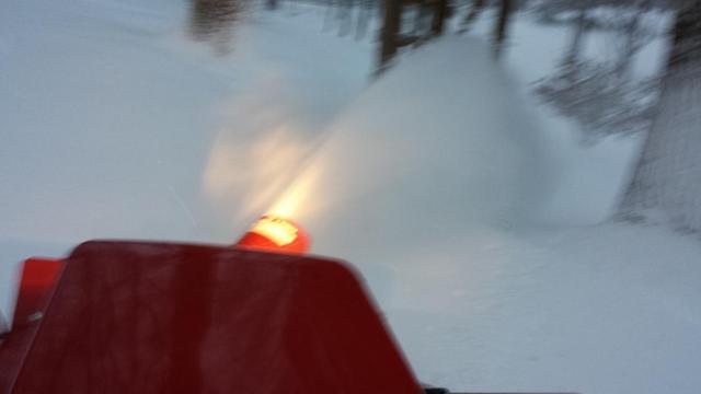

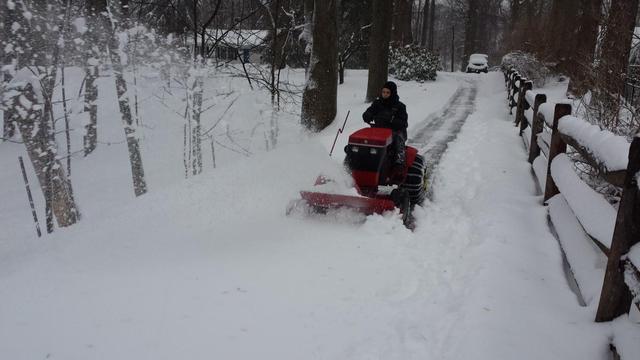

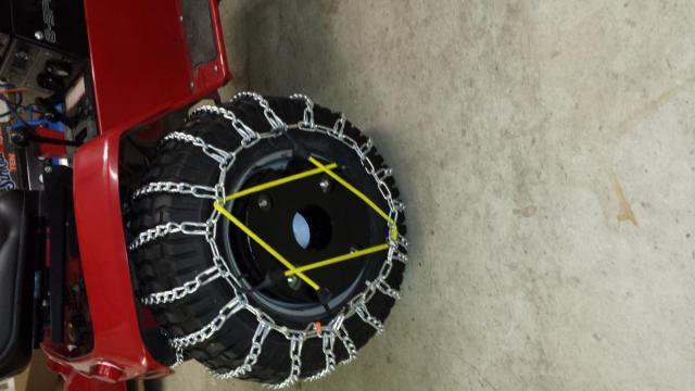

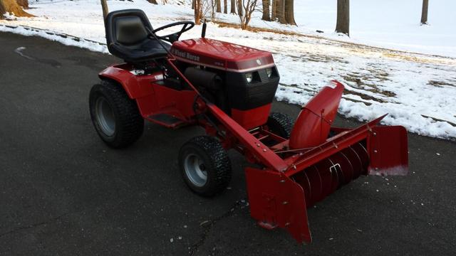

JERSEYHAWG /  Glenn
Gene. My driveway has a good steep hill to. Here is how the 416 gets set up. Imho you WILL need chains. Sorry. I also have the stock turf tires. 70lb. Weights on the rear. Unstoppable. Just like the movie. Before I had chains. Got lucky ONCE. After that the tractor wouldn't budge. There's your snowblower in action. If your afraid of ring the paving I would try the rubber chains. I want a pair myself. Best of luck.

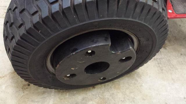

Geno
I just bought a 417A with these weights on the rear.  Does anyone know what weight they would be each?

Sparky
Those are usually around 50#'s each.
