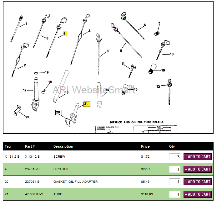

rustyedge1 201 #1 Posted August 18, 2014 I have a C-145 which has a K-341 replacement engine and I think the old 14hp oil tube and dipstick were used which gives NO oil reading when full and stick is broken ~ Trying to find out what the proper ID #s I need to replace tube and stick ~ Best I can tell the #s on dipstick are 4527204 and at the base of fill tube looks like 1236997 or 236779 can't really make out unless I pull the belt cover Has deep oil pan ~ Any help would be appreciated ~ Share this post Link to post Share on other sites
rmaynard 17,443 #2 Posted August 18, 2014 K341-71179 The correct parts for that engine are listed in the attached image. 1 Share this post Link to post Share on other sites
