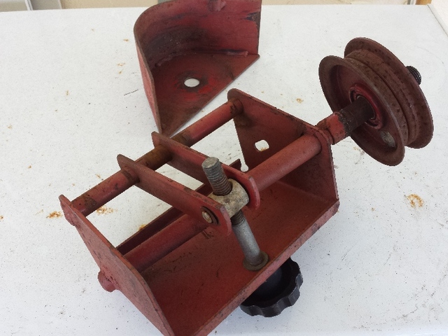

Ed Kennell 47,609 #2 Posted August 17, 2014 Does this help ? This drive is off my C-125. I think what you think is a bolt welded on is actually a stop collar for the pulleys. Share this post Link to post Share on other sites
chipwitch 73 #3 Posted August 17, 2014 That helps a little. I thought it might be a stop collar, but the bolt "looks" too new and like it may be not perfectly aligned with the rest of the shaft. The latter could be illusion, though. Are there any other spacers? Looks like about a 1/4" clearance between the pulleys. I'll need a spacer? Is there an additional spacer between the belt guard and flat pulley? Share this post Link to post Share on other sites

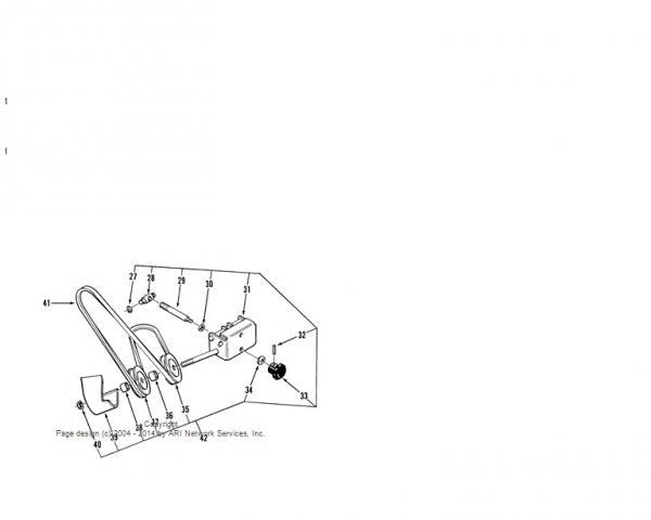

groundhog47 448 #4 Posted August 17, 2014 (edited) Is there an additional spacer between the belt guard and flat pulley? Yes, I'll do my best to copy and add an ipb. 36 and 38 spacer removable and thr omitted one here next to nain housing sometimes welded on, sometimes possibly removable. This particular one appears to be the olderremovable bearing pulleys (bearings held in with snap ring) Hope this helps somewhat Edited August 17, 2014 by groundhog47 Share this post Link to post Share on other sites
gwest_ca-(File Mod) 12,511 #5 Posted August 17, 2014 From my notes Outer spacer between cover and pulley # 101757 is 1/2" long Inner spacer between pulleys # 101734 is 5/8" long Garry Share this post Link to post Share on other sites
