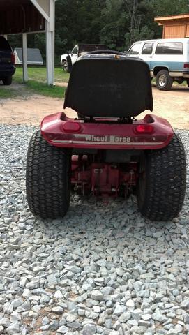

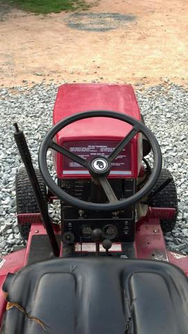

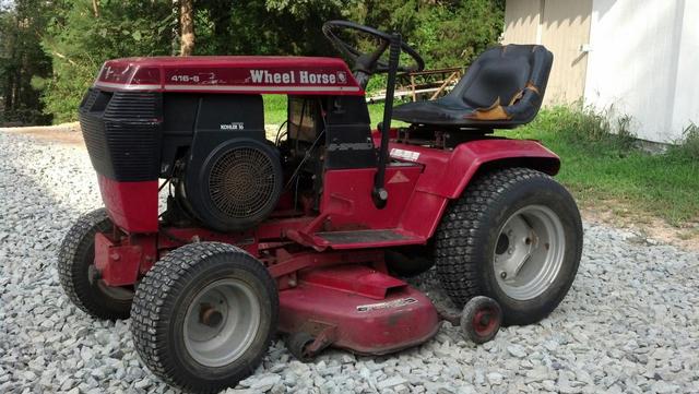

Wheel-N-It 2,967 #16 Posted August 19, 2014 OK everybody, here are the pics! Didn't get them posted yesterday due to having to work overtime. I hope you enjoy them. 3 Share this post Link to post Share on other sites
JC 1965 1,528 #17 Posted August 19, 2014 Wow !! Looks great Van. I love the kohler 16 hp K series or Mag. 1 Share this post Link to post Share on other sites
leeave96 487 #18 Posted August 19, 2014 Van - looking good! 1 Share this post Link to post Share on other sites

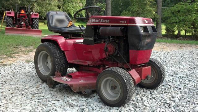

Wheel-N-It 2,967 #19 Posted August 19, 2014 One last 416 pic 1 Share this post Link to post Share on other sites
Geno 1,928 #20 Posted August 19, 2014 Very nice looking tractors you got there! 1 Share this post Link to post Share on other sites
jackhammer 544 #21 Posted August 19, 2014 Very nice , especially when they come out of the same shed. Keep your IIZ open.. and good luck 1 Share this post Link to post Share on other sites
papaglide 541 #22 Posted August 20, 2014 Very nice Van. They seem to be in pretty good shape. How do they run? I like'em! Thanks for sharing. 1 Share this post Link to post Share on other sites
Jrblanke 840 #23 Posted August 20, 2014 Duuuuuude. Look in good!!! 1 Share this post Link to post Share on other sites

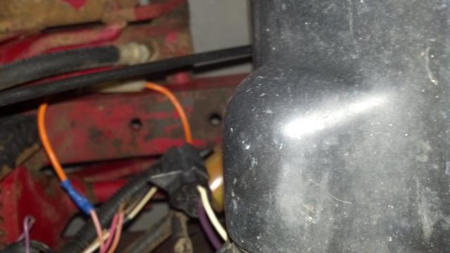

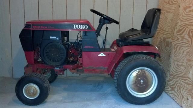

Wheel-N-It 2,967 #25 Posted September 4, 2014 OK so the cooler day has not got here yet but I could not wait any longer. Yes the 312 runs! To get it running was pretty much a no-brainer actually. First to lube up the inside I poured an once of MMO down the spark plug hole and turned the engine by hand about ten times. Then I took the bowl off the carb and sprayed it with brake cleaner. The bowl had zero rust in it so scrubbing the inside of the carb bowl was not necessary. Next thing was to connect up a battery and a remote starter switch. Then applied a couple of shots of spray carb cleaner, hit the remote starter switch and the M12 came to life. No knocking, and the only smoke was from burning off the MMO. The next thing was to blow out the fuel tank with compressed air and install a new fuel filter and put the carb bowl back on. Poured some gas in the tank, hit the remote starter and Yippee! the M12 runs on gasoline. Then out with the old oil and in with the new. Phase three was what to do about the wiring where the PO before the PO I bought the 312 from had cut up the harness and basically did a good job of showing the entire world he (or she) knew less than nothing about control circuits. So after calling Don Varos for some charging system consultation (BIG THANK YOU DON!), it was time to divide and conquor the starting circuit. After about ten minutes I discovered the seat switch was trashed, the brake safety switch was missing, and the factory fuse holders had been replaced with some ancient automotive glass fuse holders from another botched wiring project. It was then time out. After about eight seconds I decided I was not rewiring the space shuttle, so I took the path of least resistance and unplugged the 12v starting circuit wire from the PTO lever and plugged it onto the pos+ terminal of the starter relay. This made it so I could start and stop the M12 using the key switch. On to the charging system. With the engine running, my trusty FLUKE volt meter showed a healthy 13.89 vdc going to the battery. Check. Now to test out the Hydro. With 225lbs of me sitting on the seat, the hydro worked fine uphill or down. The hydro oil was very clean, so to me that was a good sign. I drove it around about 30 more minutes to get the hydro nice and hot. No leaks or slipping. Check. Tomorrow I will give it a good greasing everywhere there are moving parts. Now I have to decide what to do with it. Should I hang the tiller on it and make the 312 my tilling tractor? Well for now I'm happy it runs and drives. I'll decide what to do with it later. Or maybe take it to the Big Show in 2015 and sell it to one of you guys 2 Share this post Link to post Share on other sites
