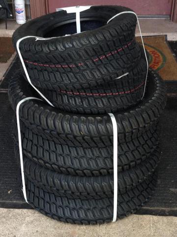

Hodge71 691 #27 Posted September 5, 2014 New sneakers for Dad's new 416 were waiting for me after work tonight...on a not so happy note...Harbor Freight lost my guns so now we need to get them reshipped..UGH..I wonder if I will ever be able to paint this tractor. Share this post Link to post Share on other sites
Sparky-(Admin) 26,266 #28 Posted September 5, 2014 What size rubber did you get? Mike...... Share this post Link to post Share on other sites

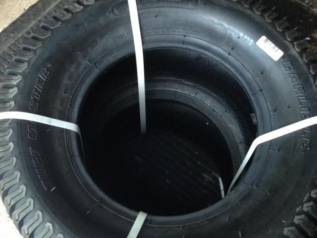

Hodge71 691 #29 Posted September 6, 2014 (edited) What size rubber did you get? Mike...... I ended up getting factory size....23x9.50-12 for the back and 16x6.50-8 for the front. I got a helluva deal on Amazon because I'm a Prime member....$168 for all 4 to my door in 2 days Edited September 6, 2014 by hodge71 1 Share this post Link to post Share on other sites

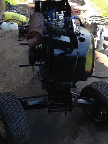

Hodge71 691 #35 Posted September 10, 2014 Started spraying Eastwood Chassis Black tonight...hope the weather holds out the frame will be back by the weekend.....pics to follow soon. It got too dark tonight Share this post Link to post Share on other sites

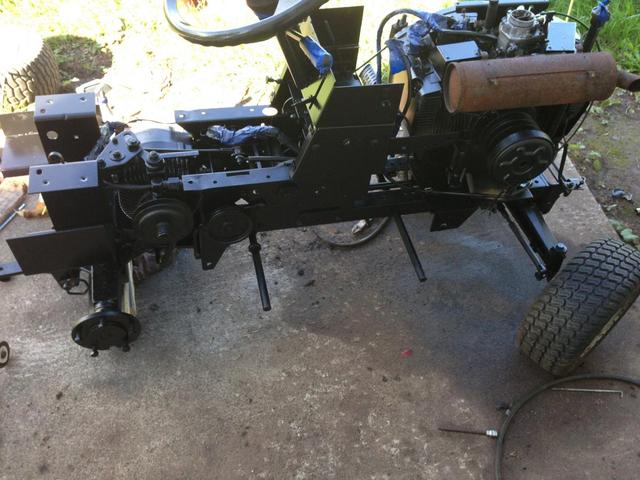

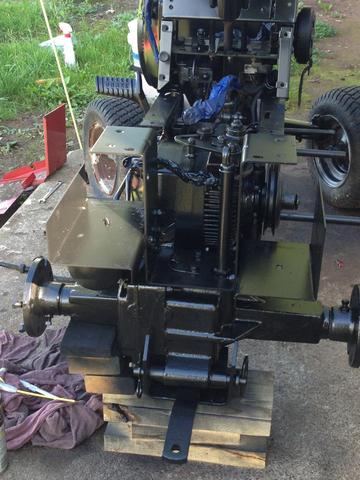

Hodge71 691 #36 Posted September 11, 2014 Heres pics of the frame done in black...I was nervous but after see in it, I think its going to look great. I have chosen a color for the tins too. International Harvester Red #50. Its a bit more deep red instead of the lighter tint Wheel Horse red has. Hope to have red flowing this weekend. 3 Share this post Link to post Share on other sites

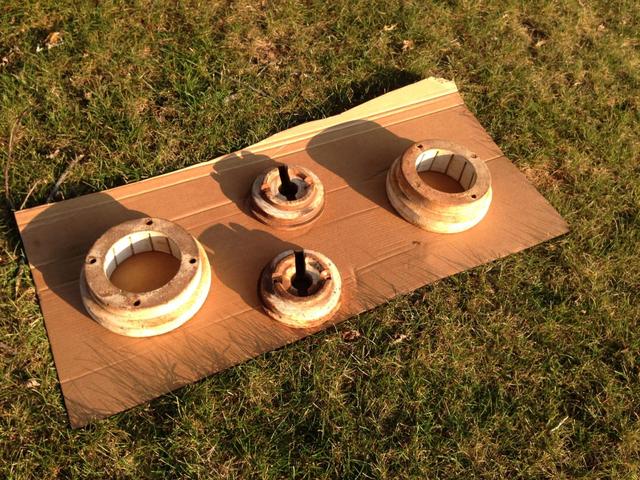

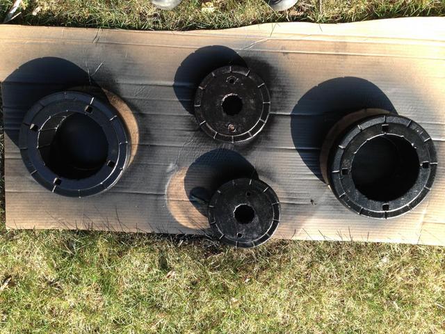

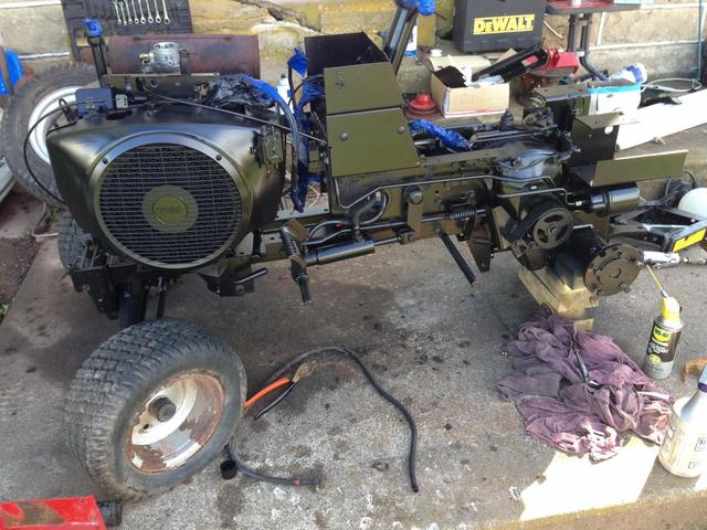

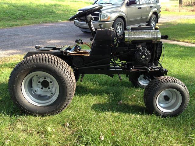

Hodge71 691 #41 Posted September 17, 2014 (edited) Things are going back together rather nicely. Still haven't had a chance to spray and red or primer yet on the tins but I was able to get gas tank back in, run new fuel line, bolted the Onan back in and changed the oil and filter in her. Tonight after ll that I threw the battery in it, cleaned the terminals and after cranking for about 10 seconds to get the fuel lines primed, it fired up and settled into a lopey idle....I may be changing my opinion of these Onans. Im not saying Im going to stop loving my Kohlers but the Onan is growing on me just a little. Tomorrow a pic of a few wires I found broken off. A pink, but think I know where it goes, but I also found 2 blacks. One had a connector on it for the voltmeter but the remaining black was just broken off with no idea where it could go...possibly the negative on the hour meter? Any input guys? I also ordered a new seat for it and a new pair of 55 watt headlights Edited September 17, 2014 by Farmhand Share this post Link to post Share on other sites

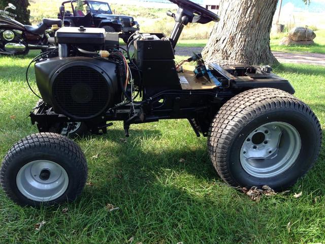

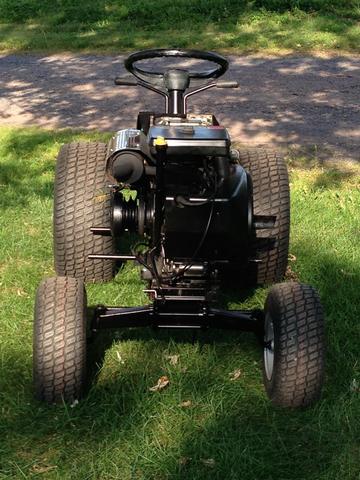

Hodge71 691 #42 Posted September 20, 2014 More progress today....worked from 5:30 to noon and after my boys soccer game I was able to work on the 416 some more. Its a roller now . I got the new rubber mounted on the wheels and got them painted. I also got the wheel weights painted with the epoxy paint.... I sorted out the electric clutch mounting and I couldn't help myself.....after I changed the oil and filter on both the Eaton 1100 and the Onan...I broke down and took it for a nice long ride around the farm. Ran flawlessly and Im very happy with it so far. Now time for some college football on the big screen and then the Bloomsburg Fair tonight once the lil woman gets here Heres pic of how she looks at this point.... 2 Share this post Link to post Share on other sites
km3h 543 #43 Posted September 20, 2014 I am really excited to see how this turns out. The Black and red should show a lot of contrast and look great. Share this post Link to post Share on other sites

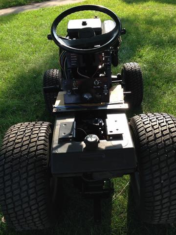

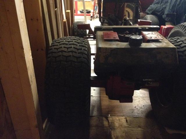

Sparky-(Admin) 26,266 #44 Posted September 20, 2014 Is it just me or are those rear tires real close to the fuel tank? The black looks fantastic! Mike.......... Share this post Link to post Share on other sites
Geno 1,931 #45 Posted September 20, 2014 Looks like there's 23-9.50-12's on the rear. They look great! Share this post Link to post Share on other sites
Hodge71 691 #46 Posted September 21, 2014 Is it just me or are those rear tires real close to the fuel tank? The black looks fantastic! Mike.......... Factory sized sneakers all the way around. 23x9.50s out back and 16x6.50s out front Share this post Link to post Share on other sites

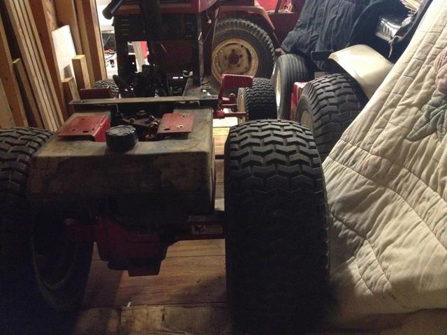

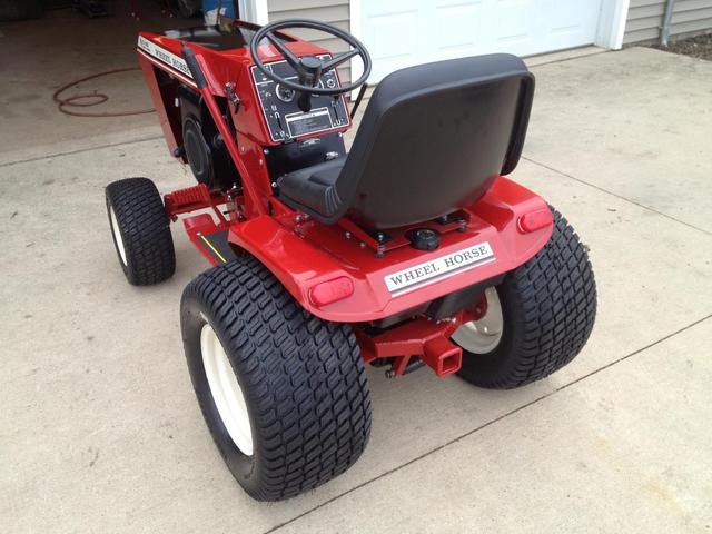

Martin 2,134 #47 Posted September 21, 2014 (edited) Is it just me or are those rear tires real close to the fuel tank? The black looks fantastic! Mike.......... they do look close. most probably the camera screwing with the shot. i went out and looked at the rolling 416H i have, same wheels and tire size as this one, when you take a pic above its hard to see the gap, but there should be about an inch on each side...... plus the tires look a little wider than the older 9.50s in my pics. the 12 x 7 wheels on the later tractors were different than the earlier 12 x 7 wheels. the later ones placed the tire closer to the tank, while the earlier ones had roughly the same clearance to the tank as the wider 520/gt1848 type wheels. Edited September 21, 2014 by Martin Share this post Link to post Share on other sites
Hodge71 691 #48 Posted September 21, 2014 they do look close. most probably the camera screwing with the shot. i went out and looked at the rolling 416H i have, same wheels and tire size as this one, when you take a pic above its hard to see the gap, but there should be about an inch on each side...... plus the tires look a little wider than the older 9.50s in my pics. the 12 x 7 wheels on the later tractors were different than the earlier 12 x 7 wheels. the later ones placed the tire closer to the tank, while the earlier ones had roughly the same clearance to the tank as the wider 520/gt1848 type wheels. IMG_3912.JPG IMG_3913.JPG IMG_3914.JPG Boy now that I see those pics Martin the tires on one are really close. They're 23x9.50 Carlisle Turf Masters and I must say I like them very much. I wasn't sure when I ordered them but they're a sexy tire once mounted Share this post Link to post Share on other sites
Martin 2,134 #49 Posted September 21, 2014 yep they sure are...... 2 Share this post Link to post Share on other sites
Hodge71 691 #50 Posted September 21, 2014 yep they sure are...... IMG_1889.JPG Share this post Link to post Share on other sites
