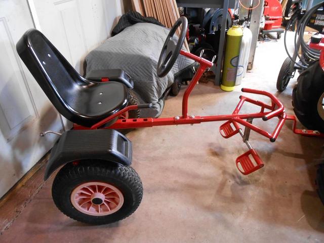

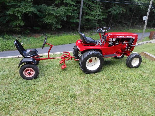

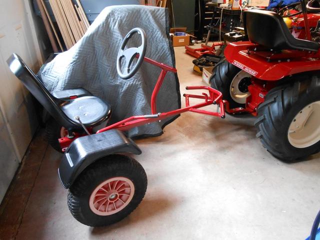

fireman 1,022 #1 Posted August 13, 2014 (edited) We had this pedal cart laying around that spent a few years sitting in the woods before we got it. The kids used it for a few years and the steering finally gave up the ghost after being fixed a few times so it sat for a while. I was about to cut it apart and haul it to the scrap metal dumpster at work when I had a vision. With the sawzall already in hand I started cutting. Next thing you know the welder came out. Cut down the length and made it so it can be taken apart for transport. Had to cut down the front sides so it doesn't hit the tractors rear tires when turning. That was two weeks ago. I started vacation Monday and since it was nice got to painting it. I think it came out pretty good for something I didn't pay a dime for and was on it's way to the scrap yard. Now I'm contimplating making a removable rear shelf for hauling any treasures I may find at the shows etc. Here's how it started life: And Now! Edited August 14, 2014 by fireman 8 Share this post Link to post Share on other sites

JimD 3,347 #13 Posted August 14, 2014 Very nice work Jeff. One question though, where does the rider put their feet? Am I missing something in the pic? 1 Share this post Link to post Share on other sites
stevebo-(Moderator) 8,742 #14 Posted August 14, 2014 Now momma will really be a back seat driver.... 1 Share this post Link to post Share on other sites
fireman 1,022 #15 Posted August 14, 2014 Feet go up on the front portion. The seat is adjustable forward and back. 2 Share this post Link to post Share on other sites

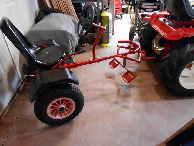

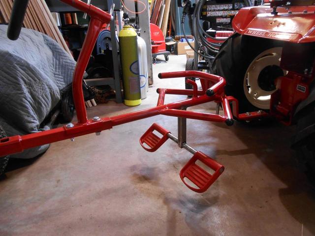

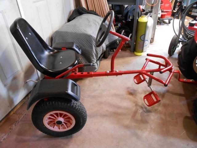

fireman 1,022 #18 Posted August 15, 2014 All right! I took it out for a spin today and having your feet up on the original front portion wasn't very comfortable. So not being able to leave well enough alone I've improved it to version 2.0. I added some real foot rests. When riding on it the steering wheel seemed way to close to me. I remembered that when I shortened the rear frame portion I had to move the steering column back also. So, I cut down the steering shaft length and added clevis pins so I can remove it if necessary. Now it's very comfortable and much more rider friendly. Just need to add some primer and paint and she'll be good to go. Share this post Link to post Share on other sites

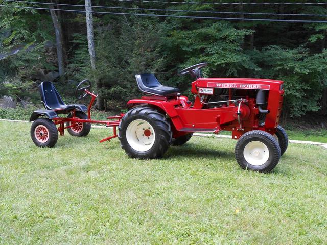

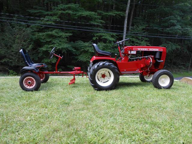

fireman 1,022 #22 Posted August 18, 2014 Ok it's all re-painted and ready to roll. Took it out for a spin with the kids and the new footrests worked out great! 1 Share this post Link to post Share on other sites
