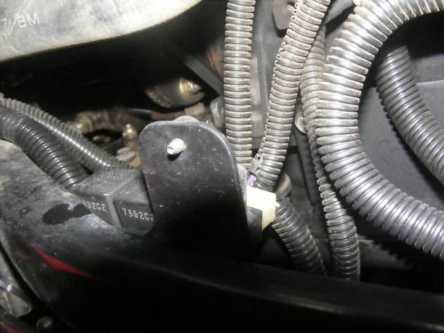

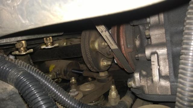

shallowwatersailor 3,222 #13 Posted August 12, 2014 Re-installing the Smart Steer sounds right. It cannot be defeated by just disconnecting it as replacement parts are required. I would go back and look at it again now that he has reconnected it. It is buried under the engine. Two lousy photos due to the rain today - one on my 518xi and the more accessible on the 523Dxi. It is in the lower center below the driveshaft. My 2000 520xi had problems at onetime with the Eaton 1100 before I bought it and was rebuilt, according to the dealer that I bought it from. Yes, they can go bad. The PO really abused it so I was not surprised to hear that. But the 5xi are extremely well-built tractors! Mine runs fine now and has the most hours on it of my three (849 hrs.) It also was the cheapest (bandit time!) The charge light also is intermittent on with this tractor but still charges. Do you know what year it is? The module is cheaper on the later years, if it bothers you. Toro added that feature just to make it look current with an "idiot light." An ammeter would have been better. The classics never had it; the alternative is they would just die when the battery didn't charge. The stalling out does concern me. Is it running on both cylinders? Any knocking from the engine? I looked at a New Holland GT 18 one time (same tractor, just blue) and it had rod knock plus down on power. The ignition modules are hidden on the engine under the shrouds and the engine must be removed to access them. Simple(?) job but two people or an engine host - and nimble fingers. The 5xi are better tractors that have a few years on them than any garden tractor purchased new today. They were just short of being the size of today's sub-compact. The nearest competitor to them is a Kubota BX (not the BX1850 - problems!) and that would an even better tractor than a 5xi. Good luck, and keep us posted! Share this post Link to post Share on other sites
fatboycowen 31 #14 Posted August 12, 2014 I plan to look again, even closer, before i buy it. How obvious would it be if it wasn't running on both cylinders? I watched him start it cold, and it started easily. It seems to idle fine. And it revs up to full throttle quickly. If it's like any cars i have experienced, it should be easy to tell if it's running on all cylinders. Like i said before, it was idling, and probably only for a few minutes, when he engaged the PTO, and started the mower. It bogged, but didn't stall. Thanks!!!! Share this post Link to post Share on other sites

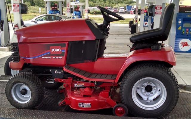

fatboycowen 31 #23 Posted August 18, 2014 Got it. Got it with a plow too, which i haven't tried mounting. It runs great. Still something funny going on with the smart steer. It only slows down when turning right (IIRC). I still don't think it goes 7.5mph in high gear. I'd guess more like 5mph. The foot pedal operation is a little strange. When you lift your foot, is it supposed to return to a stop? It seems like it sticks, and i have to push the reverse side to get it to slow down sometimes. I went up hills, and it doesn't seem to slow down, and drives great. Only other thing i can find that might be a problem is the temp gauge. I ran it for like 10 minutes, driving around the lawn, testing the mower deck, etc. The temp gauge does move, but it stays in the little orange box on the far left. It doesn't climb up into the middle. Is this normal? When i was done, i popped the hood. It was plenty hot in there. I don't know how hot they are supposed to feel, but it felt hot to me. So, is something up with the sender? Any ideas? Share this post Link to post Share on other sites
