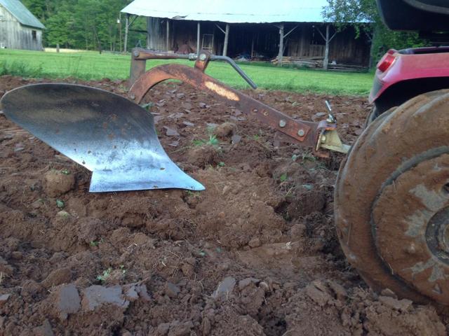

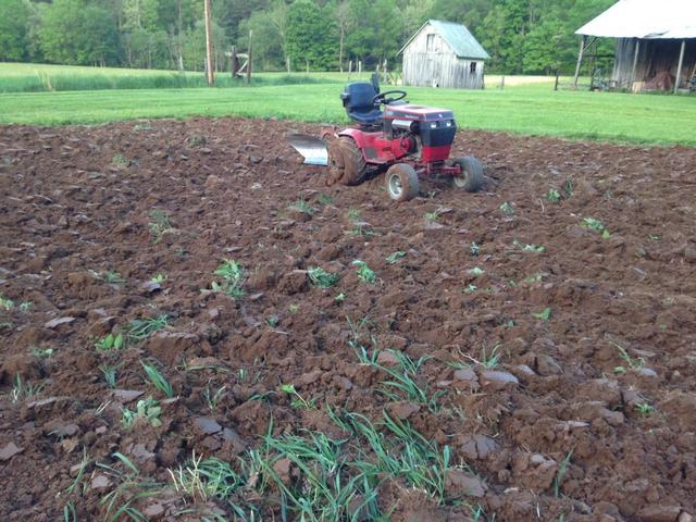

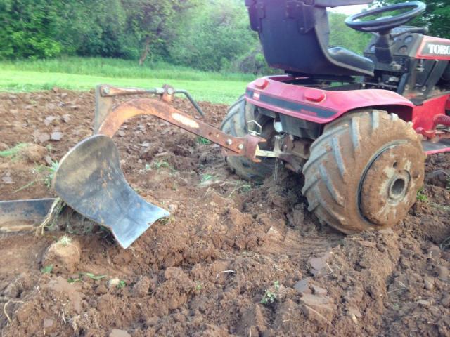

leeave96 496 #9 Posted August 15, 2014 Ive got a 12 inch and an 8 inch moldboard plow. Had a 10 inch and sold it. The 12 inch plow - by far (for me) gives the best results. However it is HEAVY and is a hard pull. I now use it with my 520H with rear weights and ag tires. The foot control kit from Matt and the hydro steering makes for a nice plow tractor. The 12 inch clevis hitch Brinly plows are hard to find. If you think you might get a larger Wheelhorse, I'd buy it while I could. Here is a pic of some plowing with the 12 inch moldboard last Spring 2 Share this post Link to post Share on other sites

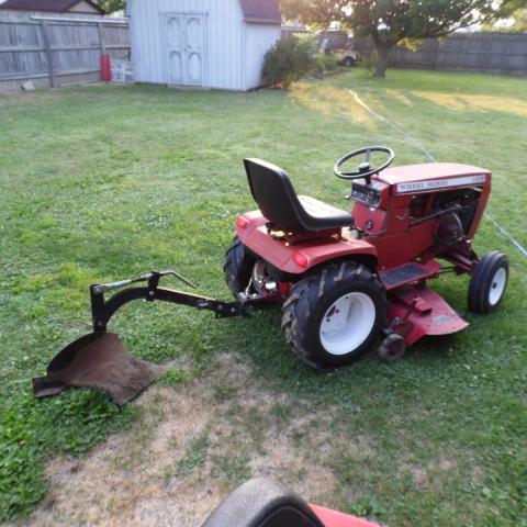

AMC RULES 37,260 #10 Posted August 15, 2014 Some calender material...that last pict is. 1 Share this post Link to post Share on other sites
