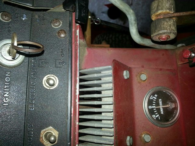

SpillerMiller 10 #1 Posted August 10, 2014 Im goingbto keep it short and sweet. What is this switch far and what does it do? Theres nothing in the manual I printed off and it doesn't seem to make any difference whether its on or off while operating tractor and pto clutch. Thank you in advance Share this post Link to post Share on other sites
Sparky-(Admin) 26,687 #2 Posted August 11, 2014 What engages your PTO now?? A manual lever? Maybe the electric clutch bit-the-dust and someone put a manual setup on it but left the switch in the dash ? What tractor are we talkin about here. Mike........... Share this post Link to post Share on other sites
SpillerMiller 10 #3 Posted August 11, 2014 C-160 automatic. And yes, it does have a manual lever on it. But it looks stock. It is exactly like my old mans set up on his C-120 manual that I used growing up. - Ethan Share this post Link to post Share on other sites
SpillerMiller 10 #4 Posted August 11, 2014 There are two prongs on the back side of that switch. One side has a wire and it runs to the ignition, but the other one doesn't have a wire on it. And I dont know where ots should end up Share this post Link to post Share on other sites
Don1977 606 #5 Posted August 11, 2014 Some one put it there for some other use, may have been extra lights. It should have a blank plug in that hole with a manual clutch. Share this post Link to post Share on other sites

boovuc 1,090 #8 Posted August 11, 2014 That's no way to fix a leaky axle. He should have used old rubber gloves and duct tape! If that switch has a wire to the ignition but nothing on the other side of the terminal, it goes nowhere and operates nothing. You should be alright leaving it as it is. Share this post Link to post Share on other sites
SpillerMiller 10 #9 Posted August 11, 2014 That was my thought exactly. It isnt hurting anything, I was just curious Share this post Link to post Share on other sites
