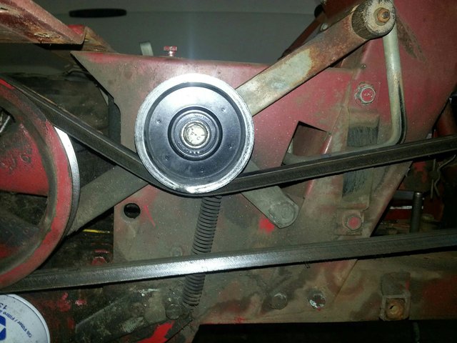

SpillerMiller 10 #1 Posted August 10, 2014 Good day fine folks. I just got an owners manual for my tractor and read it. It states that in winter the parking brake should be applied till the motor has had time to warm up properly and then release the parking brake so the belt can run the pump. Which all makes sense to me. But, my parking brake doesn't work. It appears it was taken apart and not put back together properly. Any ideas? Thank you in advance Share this post Link to post Share on other sites
SpillerMiller 10 #2 Posted August 10, 2014 Nevermind. Got to looking at it and I figured it out. Thank you if you were coming up with annidea Share this post Link to post Share on other sites
can whlvr 991 #3 Posted August 11, 2014 not sure if you wre aware that the actuall parking brake is located inside the the tranny case,its a pawl that locks against one of the gears inside,many get stripped by people pulling on them when the tractor is moving Share this post Link to post Share on other sites
SpillerMiller 10 #4 Posted August 11, 2014 I was not aware. And that probably explains why it still doesn't work. Lol But thank you Share this post Link to post Share on other sites
