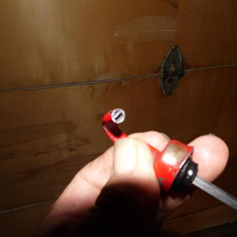

Molon_Labe 731 #3 Posted August 10, 2014 Cut the crimped end off the dipstick handle and you'll have a vent, did it to mine and it works like a charm. Share this post Link to post Share on other sites
Actonhorse 26 #4 Posted August 10, 2014 I do have the manual and page 17 doesn't really say much except to give me an index for differrent parts.... I don't see a crimped end... Share this post Link to post Share on other sites
Molon_Labe 731 #5 Posted August 10, 2014 Here's what mine looks like now Share this post Link to post Share on other sites
