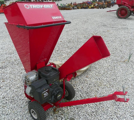

tech270154 8 #1 Posted August 8, 2014 (edited) i have a chipper-shreader TROYBUILT CS4210 with a motor briggs and stratton POWERBUILT 10 HP . right now the engine need a major rebuilt or replacement with not many choice of engine .i have a WHEEL HORSE D180 complete with a 3 points an a pto in a very good condition ,knowning the age of the tractor ,probably 1975. SO i would like to know if i could use the tractor pto to activate my chipper instead of an engine powered .the actual engine use to run it @ 3600 rpm . could i use my tractor by making a drive n`shaft to fit on the pto without killing my old engine K482 ,it will probably cut the cost of the engine 10 hp . so i am debating right now all the good and bad points .i did have the suggestion of two repondants about the speed to activate a chipper (THANKS TO BOTH OF YOU ) i am only using my chipper for composting no branches or woods goes in .THANKS for all the suggestions from all of you . i have a chipper-shreader TROYBUILT CS4210 with a motor briggs and stratton POWERBUILT 10 HP . right now the engine need a major rebuilt or replacement with not many choice of engine .i have a WHEEL HORSE D180 complete with a 3 points an a pto in a very good condition ,knowning the age of the tractor ,probably 1975. SO i would like to know if i could use the tractor pto to activate my chipper instead of an engine powered .the actual engine use to run it @ 3600 rpm . could i use my tractor by making a drive n`shaft to fit on the pto without killing my old engine K482 ,it will probably cut the cost of the engine 10 hp . so i am debating right now all the good and bad points .i did have the suggestion of two repondants about the speed to activate a chipper (THANKS TO BOTH OF YOU ) i am only using my chipper for composting no branches or woods goes in .THANKS for all the suggestions from all of you . Edited August 9, 2014 by tech270154 Share this post Link to post Share on other sites

shorts 182 #5 Posted August 10, 2014 It looks like the chipper wheel is directly mounted on the crankshaft of the engine, not like the pto or belt drive chipper/shredders that are mounted on a shaft with bearings on each end to support the chipper shaft/wheel and drive coupling. Share this post Link to post Share on other sites
Lagersolut 806 #6 Posted August 11, 2014 cs4210 chipper shreader.PNG i have a chipper-shreader TROYBUILT CS4210 with a motor briggs and stratton POWERBUILT 10 HP . right now the engine need a major rebuilt or replacement with not many choice of engine .i have a WHEEL HORSE D180 complete with a 3 points an a pto in a very good condition ,knowning the age of the tractor ,probably 1975. SO i would like to know if i could use the tractor pto to activate my chipper instead of an engine powered .the actual engine use to run it @ 3600 rpm . could i use my tractor by making a drive n`shaft to fit on the pto without killing my old engine K482 ,it will probably cut the cost of the engine 10 hp . so i am debating right now all the good and bad points .i did have the suggestion of two repondants about the speed to activate a chipper (THANKS TO BOTH OF YOU ) i am only using my chipper for composting no branches or woods goes in .THANKS for all the suggestions from all of you . I'm curious what's wrong with the engine ? I have 2 Craftsman chippers , an older '80's 4 hp and a newer 10hp - long story short I got both of them really cheap - both had the same problem - leaking oil in the impeller housing - it's an inexpensive fix ( backside crankcase oil seal ) - the newer one like yours was manufactured by MTD - my newer one has the exact engine as yours in the pic . If it's leaking crankcase oil and shutting off ( your engine is equipped with low oil shut off sensor ) your back oil seal is out , hooking it up to a tractor PTO will be a major task- the impeller - brush blade - chipper knives and flails are all bolted to, and supported by the engine itself , in addition if this unit is like mine , you will find the ( unlike my older 4 hp ) crank on the impeller end a tapered non-keyed shaft . Share this post Link to post Share on other sites

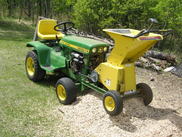

shallowwatersailor 3,222 #15 Posted September 1, 2014 Surfing another forum for ideas about my chipper, I found this Troy-Bilt chipper reworked into a PTO driven model. I'm not sure which model it is. Here is the build thread: http://www.mytractorforum.com/showthread.php?t=221992 Share this post Link to post Share on other sites

tech270154 8 #22 Posted September 4, 2014 (edited) Surfing another forum for ideas about my chipper, I found this Troy-Bilt chipper reworked into a PTO driven model. I'm not sure which model it is. TroyBilt Chipper PTO.jpg Here is the build thread: http://www.mytractorforum.com/showthread.php?t=221992 HI SHALLOWWATERSAILOR, thanks for the picture ,.it is basically what i am getting set up to built ,thanks for the picture.we have different engine model but we are getting the same result . i see ,they put the chipper on a hill of gravel,to make the same level as the tractor,it is an idea .if one day they have a chance to put their hand on a pair of wheels with a bigger diameter,they will have the same height equal,and they could move the chipper around . Edited September 4, 2014 by tech270154 Share this post Link to post Share on other sites
