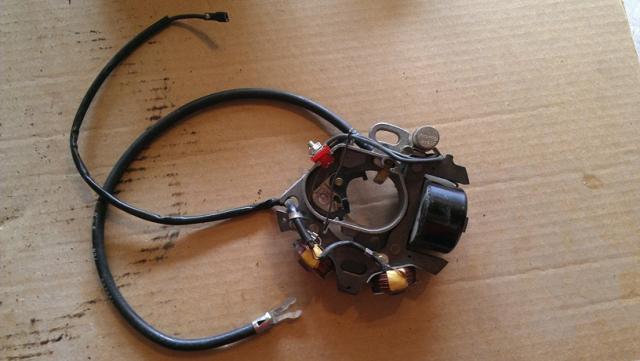

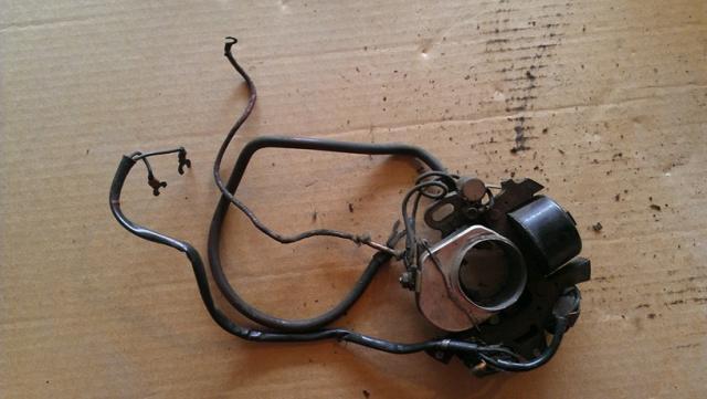

dtoeppe85 22 #5 Posted August 10, 2014 Here are a few pictures of the two magnetos. The original I removed from the engine and the 32554. The only difference I can see are that the original has two leads coming off the charging coils that connect to the rectifier and the 32554 only has one. Could I just split the one lead to two on the new magneto, or is there something else I'm missing? Share this post Link to post Share on other sites

wallfish 20,238 #7 Posted August 12, 2014 Don't think you need to split it, just use it on one side. Better yet, the correct rectifier for that coil is probably the best solution if you use it. I'm by far NOT an electrical expert so maybe someone who knows for sure will chime in. I know the manual for the older type with the diodes, recommended removing 1 diode to cut the power in half if the engine was run for long periods of time to help prevent overcharging the battery. Share this post Link to post Share on other sites
