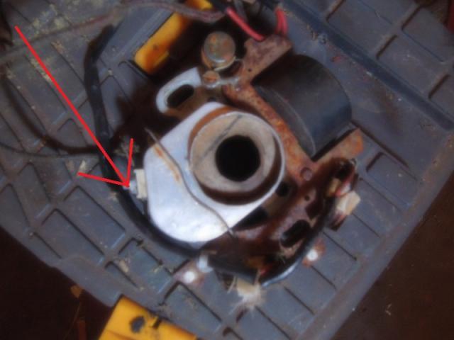

wallfish 20,159 #2 Posted August 5, 2014 There should be just one wire coming from the engine. The switch will ground that wire to shut down the engine. If there is no wire coming from behind the flywheel then you will need to connect one. The tractor manual will not cover that but the engine manual should. Click on the "Manuals" tab (upper left) and then type "H60" in the "search" to find the manual you need. Share this post Link to post Share on other sites

wallfish 20,159 #6 Posted August 7, 2014 You'll need to remove the flywheel and run a wire to ground the points with a switch. The points are under the little aluminum cover that's held down with a spring steel wire. You should see an insulated bolt coming out the side of the "can" the points are in and you should run your wire to that. When grounded by the switch, it will shut down the ignition. There will be holes on the plate you can route the wire through and out to your switch. You will probably see the broken or cut wire when you remove the flywheel. You shouldn't ground the spark plug with a switch since the spark will probably jump the contacts inside it and cause no spark all the time. OR, you can just take the easy way out and choke the carb to shut the engine down. Electric or pull start makes no difference since the only main difference between them is the starter, charging coils and rectifier. Both types use the same wire to ground the points to shut down the engine. Share this post Link to post Share on other sites

wallfish 20,159 #8 Posted August 9, 2014 Here's a pic of one which has the charging coils for electric start but I believe yours should be similar. The arrow indicates the insulated bolt to the points you can use to connect a wire. Share this post Link to post Share on other sites
