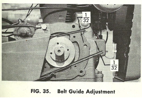

rmaynard 16,651 #6 Posted August 4, 2014 (edited) The proper belt is a #7473. 5/8" x 82". The belt guard has several guides. One on the inside, and one on the front end that projects out and over the engine pulley, and one that is under the belt coming off the engine pulley. There is a measurement in the book about how far that guide is to be set from the belt when the belt is tight around the pulleys. That measurement is 1/32" both top and bottom. As far as the noise, you need to make sure the belt is in-between the bottom of the guard and the guide on the inside. If the belt is slapping, and the clutch spring is pulling tight, I would suspect that you have the wrong belt or a stretched belt. Edited August 4, 2014 by rmaynard Share this post Link to post Share on other sites

rmaynard 16,651 #13 Posted August 7, 2014 Take the belt cover off and take some pictures of the entire assembly with the clutch released. Then have someone take a picture of the belt and idler when the clutch is depressed. Take some pictures of the inside of the belt cover and the tabs on the engine end. You said it's a new belt, but it is the correct belt? 1 Share this post Link to post Share on other sites
