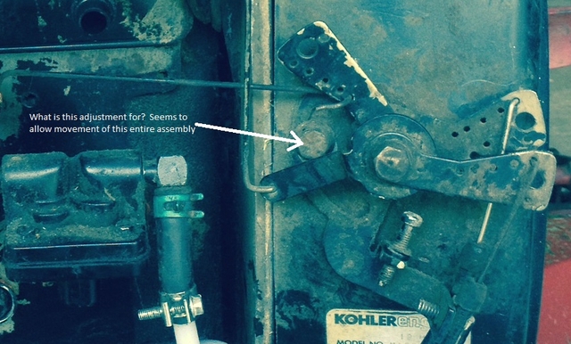

persof 14 #1 Posted August 4, 2014 What does this do? Share this post Link to post Share on other sites
rmaynard 17,642 #2 Posted August 4, 2014 What engine is that, and what model tractor is it on? Share this post Link to post Share on other sites
rmaynard 17,642 #3 Posted August 4, 2014 I'm pretty sure that is your high speed adjustment where you set the speed to a max of 3600 rpm. I'm sure I will be corrected if I'm wrong. Share this post Link to post Share on other sites
persof 14 #4 Posted August 4, 2014 Magnum 12HP from a 312-8 Share this post Link to post Share on other sites
Zeus55 38 #5 Posted August 5, 2014 (edited) Looks like the angle adapter for the throttle cable attached to the center shaft of the governor. Edited August 5, 2014 by Zeus55 Share this post Link to post Share on other sites
