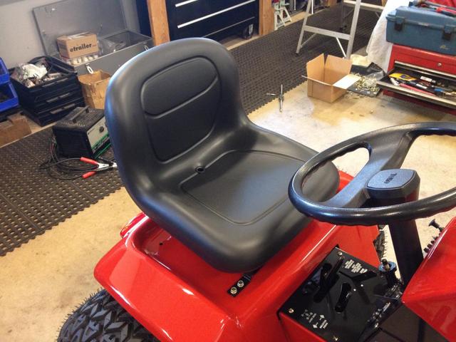

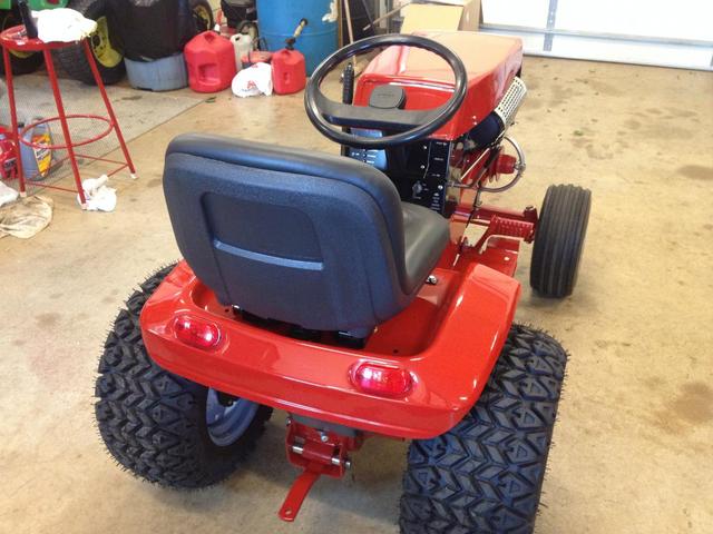

Martin 2,135 #5 Posted August 4, 2014 heres the story behind it..... heres a link.... https://www.turfseats.com/p-1859-km-123-uni-pro.aspx $91.00 shipped to my door...... Share this post Link to post Share on other sites
Navig8r 132 #6 Posted August 4, 2014 ......if you have the slide adjusters and spacers between the springs and seat, removing then could get the height down a bit, ... ......i think it is miles ahead of the seat that was on the 90s tractors from the factory, seem to sit lower and the sides hold you in comfortably..... I may try removing the slides... hadn't thought about that. I am the only one who runs the machine, so i don't need adjustability on the fly. Part of the reason the height of the seat is bothering me is probably because I am not using the tractor for mowing, but for other chores... hauling stuff, and dragging branches, etc... often on and off the seat frequently, and on uneven ground. That seat you have definitely looks like you sit deeper into it than my oem seat, I think the lateral support looks better too. 1 Share this post Link to post Share on other sites
