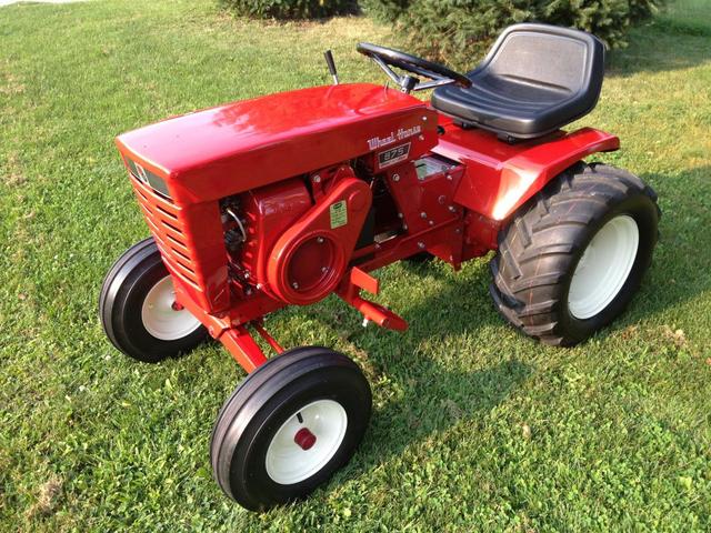

Martin 2,130 #11 Posted August 4, 2014 (edited) the 4.00-8 will work on your fronts if they are original 1276. the front wheels on the 60s tractors, and into the early 70s, were narrower than the later 5.38" later ones. if you want to see how 4.00-8 look on standard mid to late 60s fronts here is a pair on my sons 875......... this subject has been discussed before......... Edited August 4, 2014 by Martin Share this post Link to post Share on other sites
Nathanielperz 150 #12 Posted August 4, 2014 the 4.00-8 will work on your fronts if they are original 1276. the front wheels on the 60s tractors, and into the early 70s, were narrower than the later 5.38" later ones. if you want to see how 4.00-8 look on standard mid to late 60s fronts here is a pair on my sons 875......... this subject has been discussed before......... IMG_2261.JPG Those are the tires that I want to get! the front tires are 4.00-8? what is the first number? so... ?x4.00-8 Thanks,Nate Share this post Link to post Share on other sites
