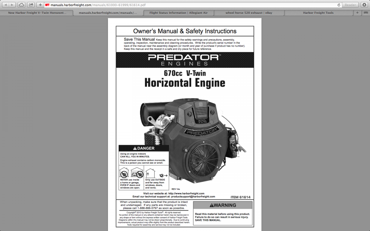

Lost Pup 190 #1 Posted August 2, 2014 (edited) http://manuals.harborfreight.com/manuals/61000-61999/61614.pdf The online HF ads for August 2014 show the new 22HP horizontal V-twin engine. My local store does not have it yet. I have found the online PDF manual for it. Looks like an option for those looking at a repower of their tractors. 22HP .......Perfect for a 520 I just passed up with a blown engine. FYI Edited August 4, 2014 by Lost Pup Share this post Link to post Share on other sites
Martin 2,135 #2 Posted August 2, 2014 (edited) decent looking engine. might be worth looking into, only 1" shaft mentioned in the manual though.... does have a front mounted oil filter for easy access on the horses...... Edited August 2, 2014 by Martin Share this post Link to post Share on other sites
