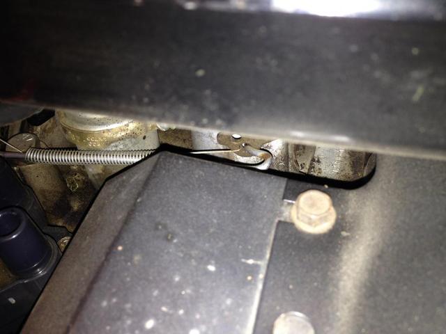

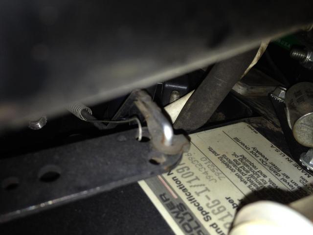

Martin 2,134 #12 Posted August 25, 2014 you shouldn't have any tension on the carb throttle when the engine isn't running. only the slight weight of the governor assembly should be there. the linkage from the governor arm to carb should move freely back and forth without much effort at all. there is two types of link, one without the spring and one with the spring coiled around the straight part of the link. we are talking about the coiled spring here right? heres how each end of the spring is hooked up. carb end governor arm end Share this post Link to post Share on other sites
6wheeler 676 #13 Posted August 25, 2014 That is how I had it hooked up. So, Maybe I am not losing it . I will try to get the governor apart tonight. Funny though, when that spring is hooked up there is light tension on the arm and, no tension at all when un- hooked. Thanks again all for your help. Pat Share this post Link to post Share on other sites
boomers_influence 106 #14 Posted August 25, 2014 club the spring shown in martins last post IS NOT installed correctly. on the carb end it goes to the OPEN hole. ( that hole, was never there before the spring was used ) on the governor arm the spring goes in the LITTLE hole. ( there again, that hole was never there before the spring was used ) thank you. boomer Share this post Link to post Share on other sites
djohn24 10 #15 Posted August 31, 2014 I wasn't having the issue 6Wheeler was having. Mine was lack of rpm's. I was only getting 2900 rpm at full throttle. I did adjust the throttle cable a little and was getting 3200 rpm. My linkage was hooked up the same as the pictures Martin had posted. So, I took Boomers advice on how to hook the linkage. I fired it up and opened to full throttle...I now have 3600rpm!! Thank you Boomer! Share this post Link to post Share on other sites

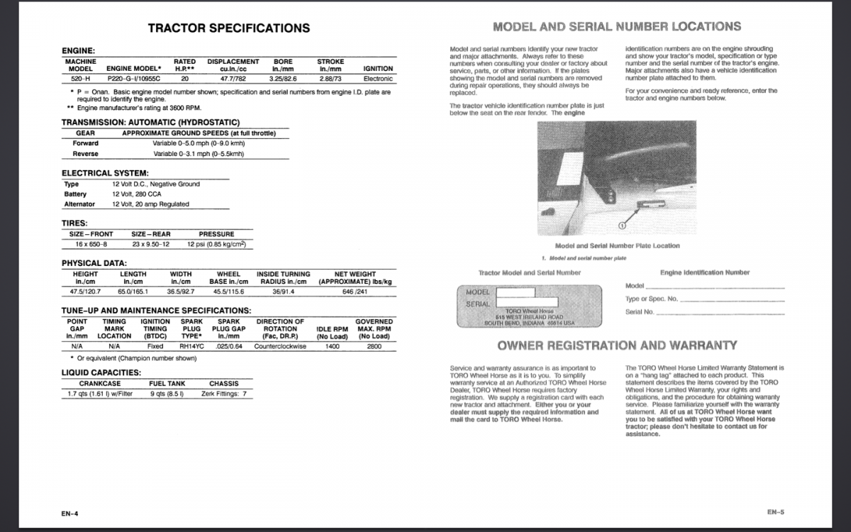

djohn24 10 #20 Posted September 1, 2014 Thank you, TBarnhart & Martin. I have now developed another question. In my quest for more rpm's. I may have been wrong. The tach at full throttle was 2,900 rpm. With the adjustments made it's now hitting the 3,600. I was reading a Wheel Horse manual last night and in the specs area and it states...Max rpm...2,800 rpm. So, if anybody has any input on this that would be great! Share this post Link to post Share on other sites

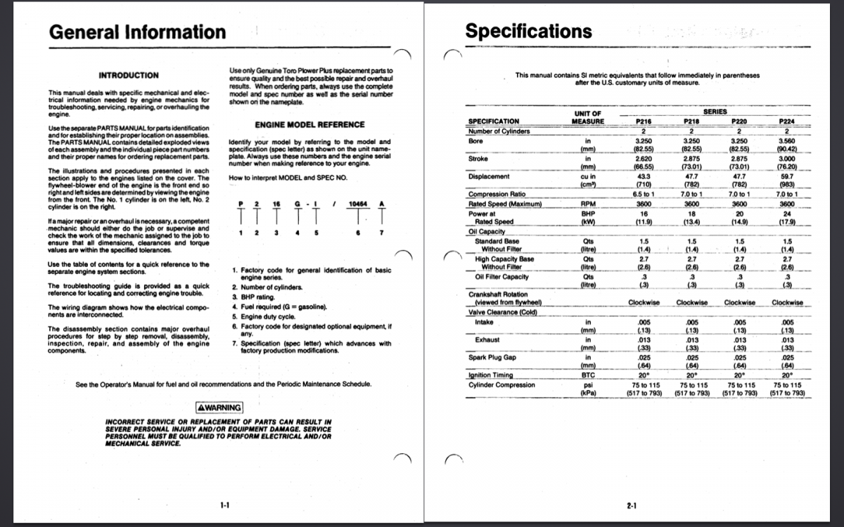

Martin 2,134 #21 Posted September 1, 2014 all the P series engines in the Wheel Horse tractors were governed to 3600. Onan had many different applications and the engines were governed to the way the engine was used in that application. for our purposes though 3600 rpm is the magic number. what Wheel Horse manual were you reading that in? here is the specs from the Toro Power plus manual 492-4006. Share this post Link to post Share on other sites

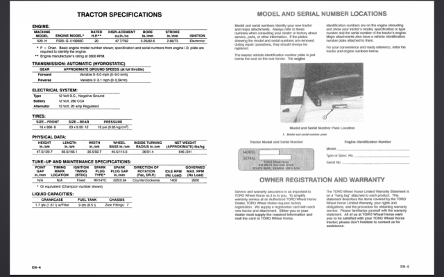

djohn24 10 #22 Posted September 1, 2014 3315-395EN 1991-94 520-He OM.pdf Here is the manual I got the info from. Saying it's a 91-94 520 manual. Share this post Link to post Share on other sites

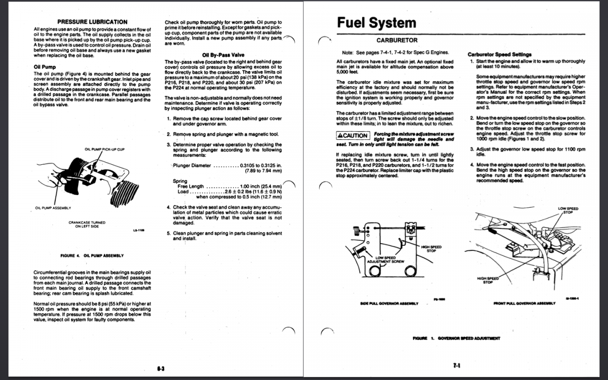

Martin 2,134 #23 Posted September 1, 2014 is this where you got this info? maybe somebody here can explain why they even have this measurement here as its not needed to set the max speed on these engines. if it was set at this speed you wouldn't get your rated power from the engine. at the top of that page it says engine manufacturers rating at 3600, so why would you set it at 2800? here is the method in the manual... Share this post Link to post Share on other sites
Theroundhousernr 590 #24 Posted September 1, 2014 Some generator heads run at 2800. Less fuel consumption and less racket. Share this post Link to post Share on other sites
djohn24 10 #25 Posted September 1, 2014 Yes, that is where I got it. I agree, doesn't make sense for the tractor. Would make sense for a generator like Theroundhousernr mentioned. It's clearly in reference to the Wheel Horse. Maybe some other Onan owners will jump in here to mention what rpm's they are running at. Oh Martin, I mentioned your engine as being a" 94" by the engine Id tag in your picture above. Which I also have a 88 516H. However, the engine ID tag on that is 87. My 520H has a 94 on the engine ID tag and the ID plate on the tractor has been painted over and the previous owner tried to recover it without luck. I call my 520H a 94 but I'm guessing it could be a 95 also. Share this post Link to post Share on other sites
