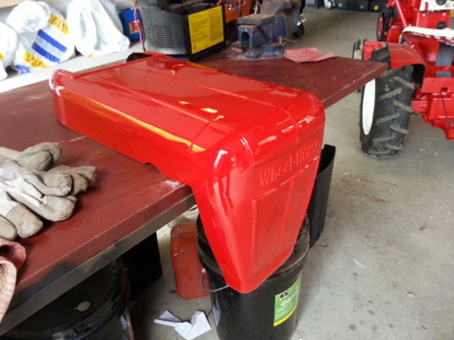

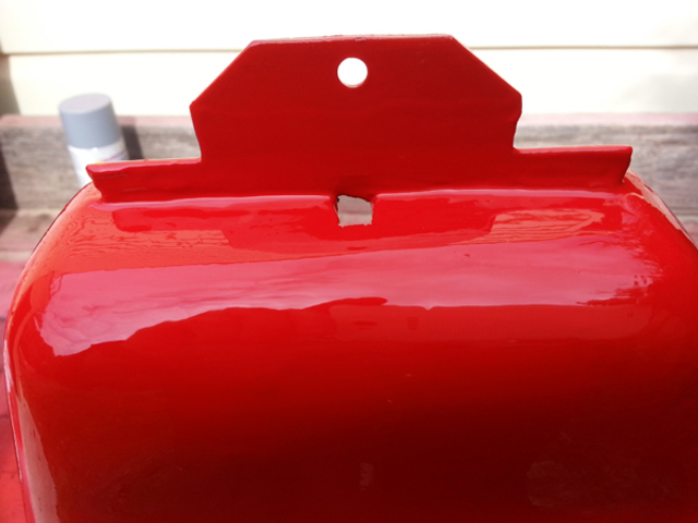

Zeus55 38 #51 Posted September 15, 2014 (edited) How is the hood coming along. Excited to see finished tactor. Hope all is going well and waiting for the finished pictures. Working on it... lots of cracks and metal fatigue. There are also 4 holes in the hood that I'm filling; 2 big holes each side for lights, and a couple of smaler ones. I won't put any lighting on it. Should be finished this week. Edited September 15, 2014 by Zeus55 Share this post Link to post Share on other sites

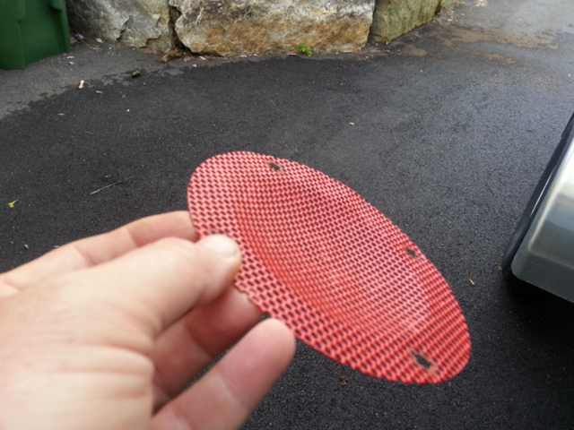

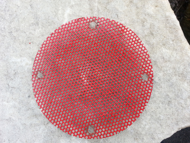

Martin 2,134 #53 Posted September 16, 2014 (edited) nice work on your build so far. what sort of screen do you have on the flywheel pulley? its hard to see in the pics what is there, but these engines rely on a good intake of air through that area to cool them, especially at max rpm. like i said its hard to see what you have on there as a mesh type screen, but i would try and make sure that it has at least the same amount of area of open holes for air to flow through. once again, the tractor looks really good, you have done a nice job on the rebuild..... Edited September 16, 2014 by Martin 1 Share this post Link to post Share on other sites
Catmanii 36 #54 Posted September 16, 2014 Working on it... lots of cracks and metal fatigue. There are also 4 holes in the hood that I'm filling; 2 big holes each side for lights, and a couple of smaler ones. I won't put any lighting on it. Should be finished this week. Thank God for wire feed welders when it comes to fixing cracks and holes. Just fixed the sheet metal on my KT-17 that had a crack in it. My C-120 has the two big holes for lights that offend me and is on my list for removel. Don't plow snow in Texas so don't need lights. Don't know why I keep them working on the C-175. Cause they are there I guess. Really like you little tractor and you have done an excellent job on your rebuild. Keep up the good work. Share this post Link to post Share on other sites
Zeus55 38 #55 Posted September 16, 2014 nice work on your build so far. what sort of screen do you have on the flywheel pulley? its hard to see in the pics what is there, but these engines rely on a good intake of air through that area to cool them, especially at max rpm. like i said its hard to see what you have on there as a mesh type screen, but i would try and make sure that it has at least the same amount of area of open holes for air to flow through. once again, the tractor looks really good, you have done a nice job on the rebuild..... Here is some pictures of it. It have a concave shape in the middle... seems to be the original part. Share this post Link to post Share on other sites
Martin 2,134 #56 Posted September 16, 2014 that looks ok. it looked like almost a solid disc in the video and pics you posted earlier. I'm not 100% on what a 7 hp Kohler had but that looks to be a typical Kohler screen. Share this post Link to post Share on other sites
Firpo701 408 #57 Posted September 17, 2014 Yep...looks just like mine. ;-) Share this post Link to post Share on other sites

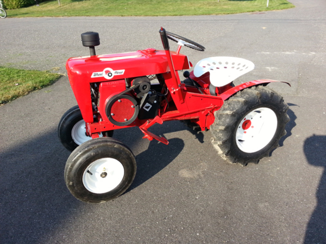

Zeus55 38 #61 Posted September 30, 2014 Project is now over Remember the bottom front of the hood ? lots of cracks, holes and rust. I love the end result ! Here is the revived horse... it works like a new one. Many thanks for the help and support 5 Share this post Link to post Share on other sites
