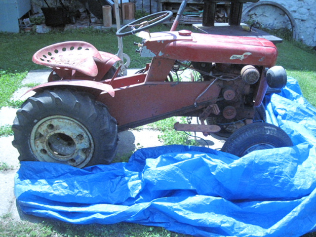

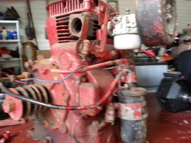

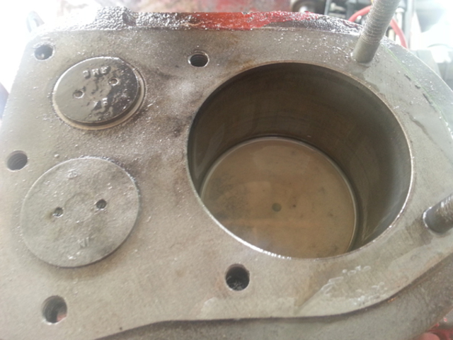

Zeus55 38 #1 Posted July 30, 2014 (edited) Ok... Like mentioned in my "New Guy" thread, I'm opening this new thread for my first restoration of a 701. First thing I wanted to make sure is the engine condition so I removed it and made all measures of the most important specifications, and I was happy to see that it did'nt have much wear and all measures met specs, so I don't need to rebuild the engine. Just a good cleanup and paint job! Here is the beast... Edited July 30, 2014 by Zeus55 Share this post Link to post Share on other sites

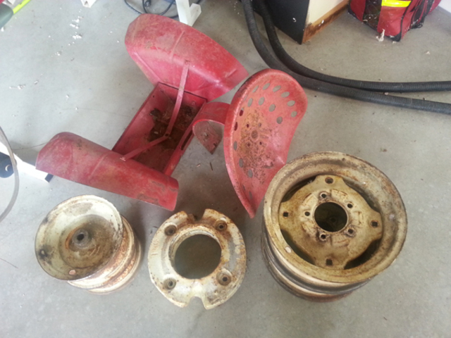

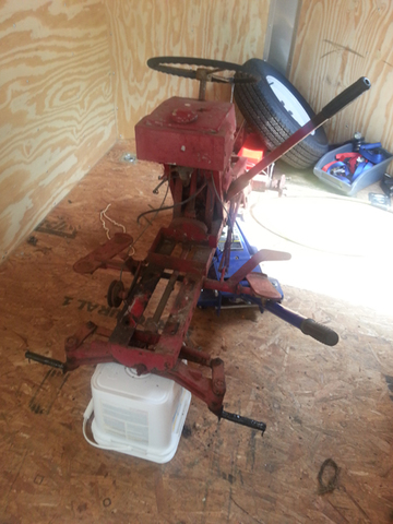

Zeus55 38 #5 Posted July 31, 2014 (edited) This is the fun part... disassemble the tractor Taking all the parts off and look at them separatly and see witch one need more love than the others. Most parts looks OK... engine and transmission don't need complete rebuild Sheet metal needs more attention and I will work the parts from the ground up. Now it's time to go for a ride... Edited July 31, 2014 by Zeus55 Share this post Link to post Share on other sites

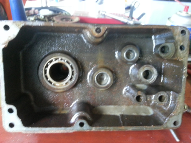

Zeus55 38 #7 Posted August 2, 2014 Oups... when I removed the transmission plug, there been a lot of water coming out of it. Probably will have to rebuild it! Share this post Link to post Share on other sites
Sparky-(Admin) 26,560 #8 Posted August 2, 2014 Oups... when I removed the transmission plug, there been a lot of water coming out of it. Probably will have to rebuild it! Yep...you definitely will want to split the tranny and see how it looks in there. Mike...... Share this post Link to post Share on other sites
Firpo701 408 #9 Posted August 2, 2014 That seems to be a common problem on the front engine round hoods. If they sit out in the weather, it seems that the dash tower funnels the rain directly to the shifter. And...if you have a bad boot, you end up with an axle full of water. My original trans got to the point of popping spider gears left and right in the late 80's. Being that this was before the internet, I had a hard time locating another axle. The one I found had been laying on a hillside in the weeds for who knows how long, and, it was full of water. I drained it and changed the gear oil and worked it. It again gathered water a few years later, so I changed it again. I have since worked it half to death with no problems. Just telling you my experience...I probably would split the case and check for any pitting of the gears, and, I would definitely put a new shifter boot on it. A friend of mine has had the same problem with his 753. Share this post Link to post Share on other sites
Zeus55 38 #10 Posted August 3, 2014 Yes there is no shifter boot at all and water must have gone throug from there. I remember my grand-father use to fill up that boot with grease just to make sure water would not get in the transmission. Was messy but effective! 1 Share this post Link to post Share on other sites

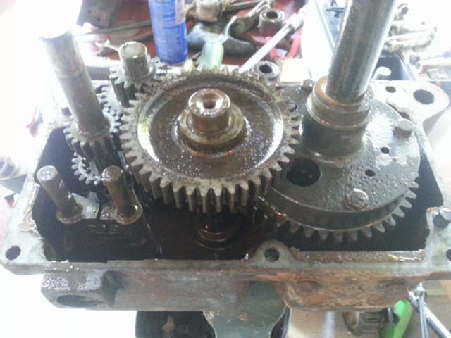

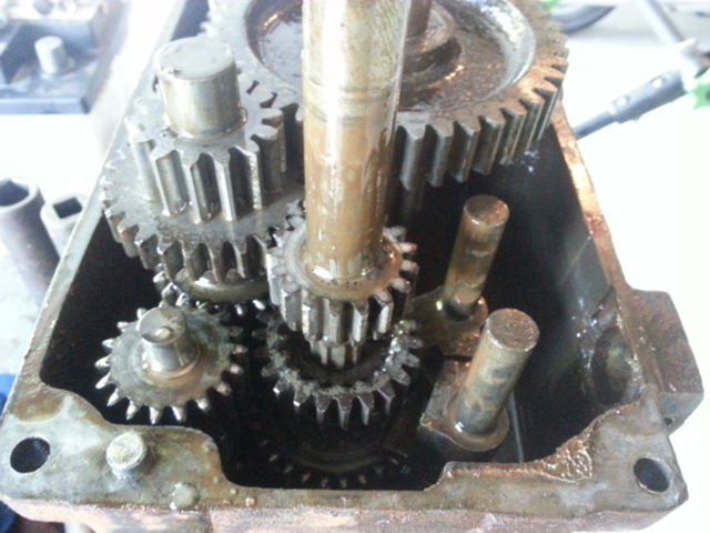

Zeus55 38 #11 Posted August 9, 2014 Almost done with the engine, I will put some pictures when done. For the transmission, I'm happy to see that there is no rust or damage to the gears, the bearings and needle bearings are in great shape. A good overall cleanup and lubrication should bring this baby to life again. The seals are not leaking but I think I will change them anyway. 1 Share this post Link to post Share on other sites
stevasaurus 23,859 #12 Posted August 9, 2014 (edited) You took the trans apart upside down...that is OK, but when you put it back together, build the trans in the shallow side and close by placing the deep side on last. Do you have the manual for the trans?? Your trans #5007 is in section II. 492-4004.pdf (application/pdf Object) Edited August 9, 2014 by stevasaurus Share this post Link to post Share on other sites

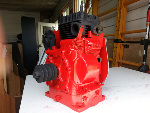

Zeus55 38 #13 Posted August 10, 2014 (edited) You took the trans apart upside down...that is OK, but when you put it back together, build the trans in the shallow side and close by placing the deep side on last. Do you have the manual for the trans?? Your trans #5007 is in section II. 492-4004.pdf (application/pdf Object) Yes I have the manual. Thanks for the "upside down" comment, it's my first on and I had 50% of chances to do it right and I misted it... but it's ok, I'll put the cover back on and turn it over. I'll put pictures on my next post... The engine is now done and painted. Next step will be to start it . Edited August 10, 2014 by Zeus55 Share this post Link to post Share on other sites

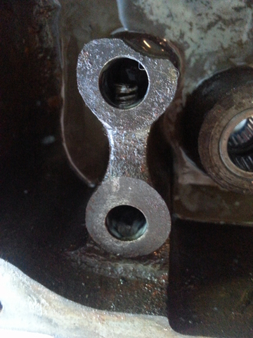

stevasaurus 23,859 #14 Posted August 11, 2014 (edited) Do not put the cover back on and turn it over. Just pull out all the gears the way it is. Here is the deal...by taking off the shallow side, you pulled the shift fork shafts out of the post holes where the detente balls go. You now have (hopefully) 2 ball bearings loose inside you trans. They are 1/4" ball bearings. Also look for the spring and stop piece...could still be in the half you pulled off in between the post holes. You could damage that spring if it is in the way of any shafts by trying to put it back together. Just take it apart and find those pieces. Here is picture of the parts...the spring, stop and 2 balls are sitting just to the left of the differential pinions. Edited August 11, 2014 by stevasaurus Share this post Link to post Share on other sites
Zeus55 38 #15 Posted August 11, 2014 Ok Thanks for the advice and you're right, I have to remove everything anyway so one way or the other will be ok 1 Share this post Link to post Share on other sites

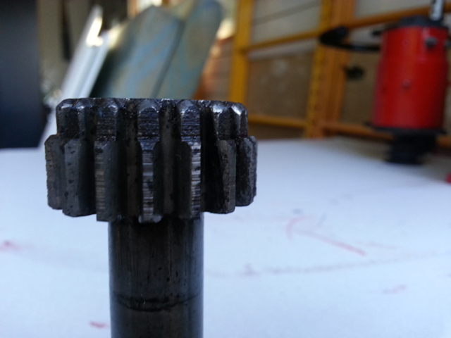

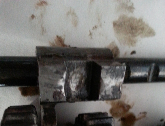

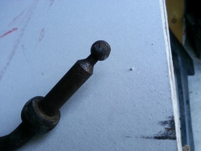

Zeus55 38 #16 Posted August 11, 2014 Found the spring and ball bearings where they should be... in the bottom of the wholes and the spring was where it should be. I found wear on the Input gear, the forks and shift stick. Is this wear normal or excessive ? Thanks! Share this post Link to post Share on other sites
stevasaurus 23,859 #17 Posted August 12, 2014 (edited) Your input shaft gear looks to be OK. Check the inside of the 2nd/3rd fork gear for wear also. This fits on top of your input shaft gear when you are in 3rd gear. The wear between these is why a trans will slip out of 3rd with a load. If you have a good fit, you should be OK. Is this just going to be a ride around/show tractor or a worker?? There are some pictures on this site that show a good and bad input and 2nd/3rd fork gears. Maybe just file the burrs on the fork shaft...and the shifter ball has some wear, but should be OK. This horse definitely has had some use. Edited August 12, 2014 by stevasaurus Share this post Link to post Share on other sites

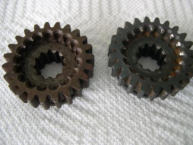

Racinbob 13,223 #18 Posted August 12, 2014 Here's one of the pictures Steve mentioned. The gear on the left is a NOS I found. 1 Share this post Link to post Share on other sites

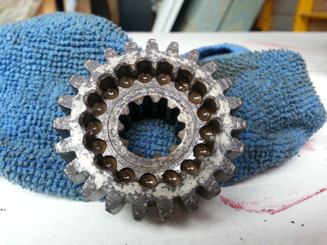

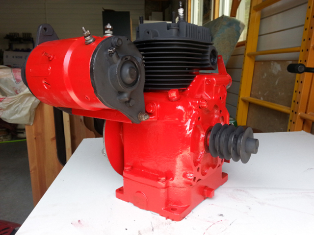

Zeus55 38 #19 Posted August 12, 2014 (edited) The gear looks good to me, it fits the input gear solidly without any loose so I figure it's OK... I added some pictures of the engine. Working on the trany and waiting for the carb and fuel pump kit. I will try to polish both of them, it should look nice. To answer the question about the use of my 701, I will not do any exposition or hard work, just running around in the wood and haul the grand kids in an wagon that I will make next, looking for blueberries, raspberries and other good little fruits . This little guy is 53 years old and I will give him an easy retirement Edited August 12, 2014 by Zeus55 4 Share this post Link to post Share on other sites
Racinbob 13,223 #20 Posted August 12, 2014 I like the contrast on the motor and the polished carb and fuel pump will look good. I would be a bit concerned about that gear though. Steve and/or Mike will probably chime in and they knows better than me. Share this post Link to post Share on other sites
stevasaurus 23,859 #21 Posted August 12, 2014 (edited) Your choice Zeus, but Bob is right. That gear looks pretty bad for all the work you are doing. The one RacinBob saved (right side of that picture) is a much better choice if he wants to part with it. Compare the pictures mate. Edited August 12, 2014 by stevasaurus Share this post Link to post Share on other sites
Zeus55 38 #22 Posted August 13, 2014 (edited) Wow... been loking for a new one on the internet but everywhere I look it's not available or discontinued. Do you think a machine shop can fix it ? Thanks! Edited August 13, 2014 by Zeus55 Share this post Link to post Share on other sites
stevasaurus 23,859 #23 Posted August 13, 2014 Probably not. See if Bob wants to part with his...if not...send a PM to "racinfool40" he is in Ohio and sells used (good) gears for transmissions. Share this post Link to post Share on other sites
Zeus55 38 #24 Posted August 13, 2014 Ok I've sent an e-mail to racinfool40 about it... Thanks! Hey Bob... is yours for sale ? Share this post Link to post Share on other sites
Racinbob 13,223 #25 Posted August 13, 2014 (edited) Well, I don't know about that but I do know I can get it in your hands . The gear on the right is the one I replaced from my transmission. At the time I bought the NOS gear I didn't think the original would work. But Steve felt it would be fine in a non-worker and, after attending the Stevasaurus Transmission University, I think so as well. Keep in mind, I didn't say I graduated....I just attended . I had another issue involving the engagement and once that was resolved the original gear probably would have been fine. Edited August 13, 2014 by Racinbob 1 Share this post Link to post Share on other sites
