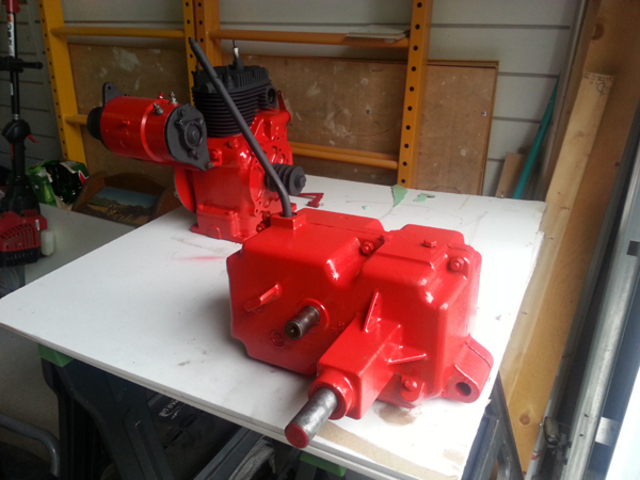

Zeus55 38 #27 Posted August 14, 2014 Good thing done. The engine and trany have been rebuilt and it's now time to attack this pile of junk For the transmission I'm waiting for the boot and knob I've ordered. I've started etching the tractor base and it will take a little more work. I also will have to get new tires for this horse. 1 Share this post Link to post Share on other sites

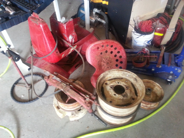

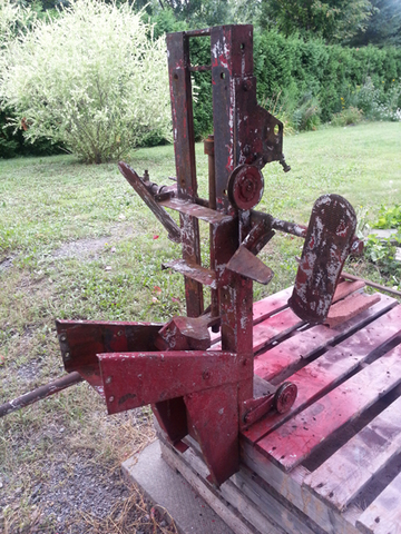

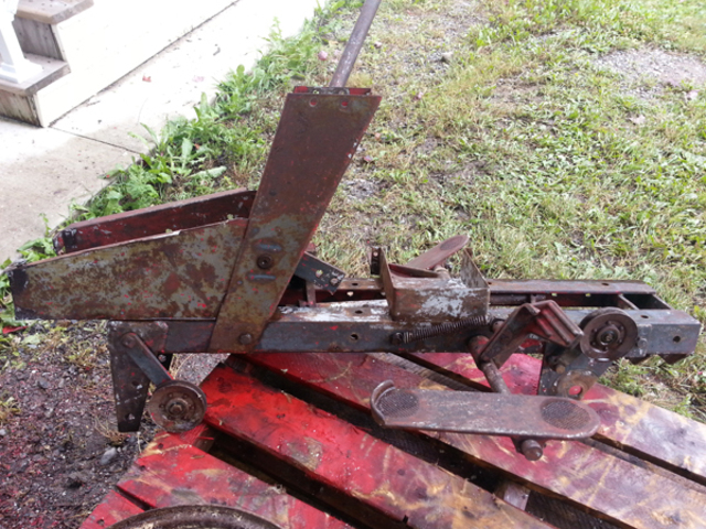

Zeus55 38 #30 Posted August 15, 2014 (edited) Wow... lots of paint coats on this horse This little guy was red, than grey, then dark red, then kind of silver and back to red. I will need a lot of stripper (no... not the one who takes her cloths off ) but the one that melts paints. I will put some pictures of the stripping Edited August 16, 2014 by Zeus55 Share this post Link to post Share on other sites

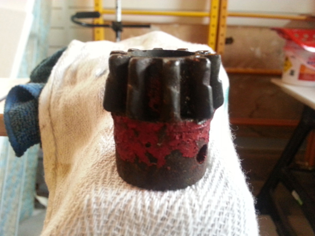

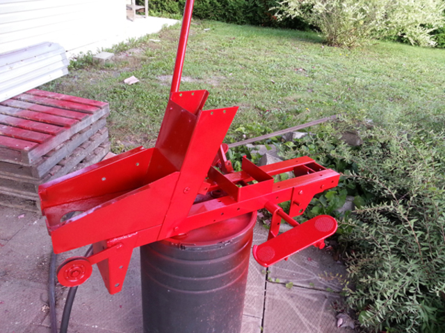

Zeus55 38 #31 Posted August 16, 2014 Here is the naked horse... a couple of hours or brushing and it will be ready for paint. The other one is the bevel pinion streering gear. There is a lot of wear on it and I will try to look for another one... somewhere! 1 Share this post Link to post Share on other sites

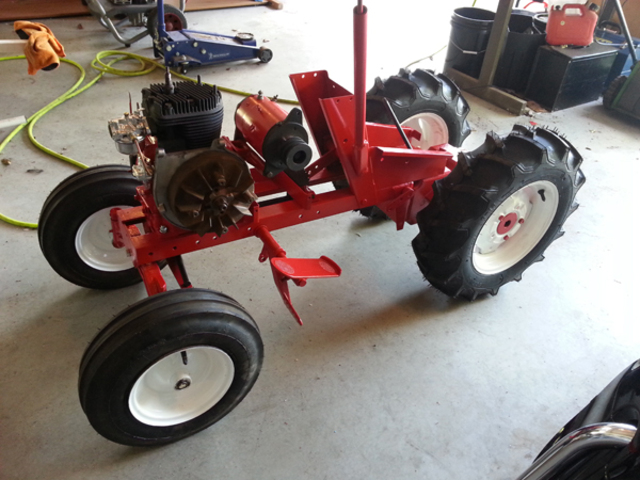

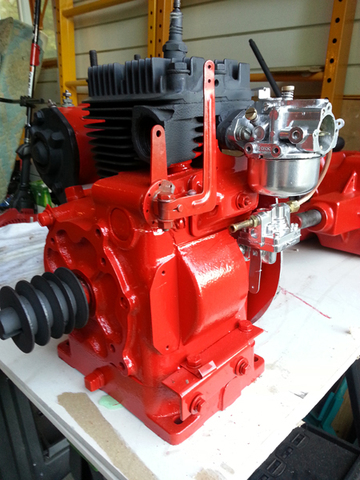

Zeus55 38 #32 Posted August 20, 2014 (edited) Looking a little better the picture is a little bright because it is the same red as the engine... My wife want the next one for her and she want it PINK Got my carb kit and rebuilt it. Now it's time to get some new rubbers. A little hard to find but found what I nead at M.E. Miller in Ontario; 2 x 4.80-4.00-8 3-Rib for the front, and 2 x 6-12 Carlisle Tru Power for the back. Edited August 21, 2014 by Zeus55 Share this post Link to post Share on other sites

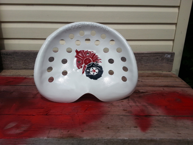

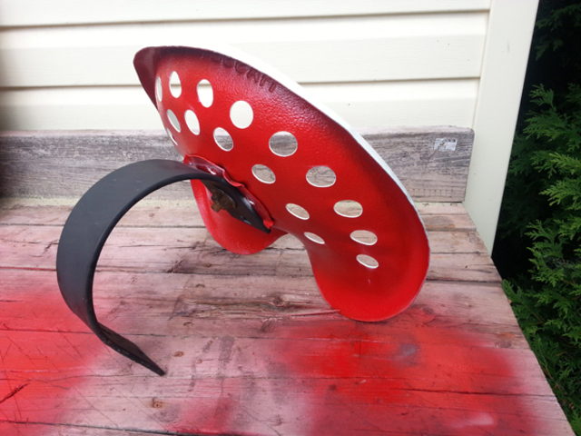

Zeus55 38 #33 Posted August 22, 2014 I always liked those tractor metal seats, they have a vintage look and have an artistic side... I decided to put a little more work on it. Painted the base in mat black, under the seat in red and the seat in white with a little artistic touch 2 Share this post Link to post Share on other sites

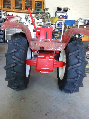

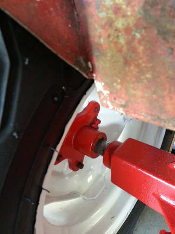

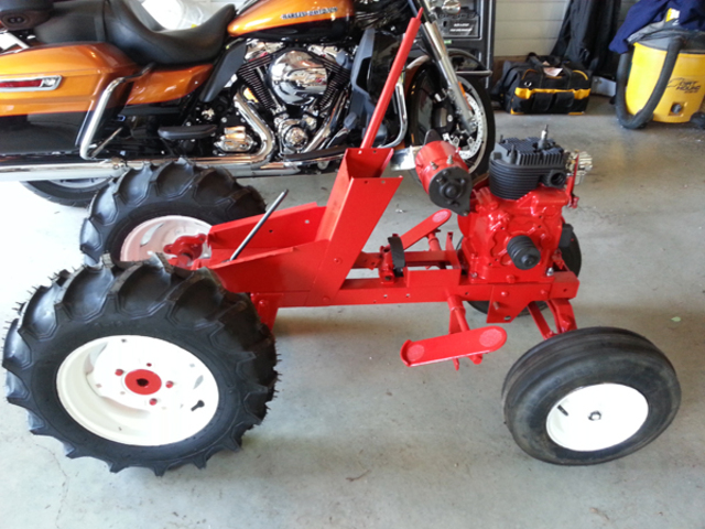

Zeus55 38 #36 Posted August 27, 2014 Ok... Here is where I'm at. The horse is starting to look like something but I have a problem with the fenders. It seems that the back is not wide enough. Maybe the tires are to big but I have 6-12 like the previous ones. I tried to put the wheel as far as possible on the shafts and it's not enough. If I compare with the initial picture, I think the tires are too high, but there is enough space between the fenders and the tires... any advice or I might modify the fender box. Share this post Link to post Share on other sites
CasualObserver 3,417 #37 Posted August 27, 2014 I was looking at other 701 pictures and something was different... I just found out that the fenders and seat were mounted backword on the one I've bought That's pretty common. The 701 fenders really stuck out at the back and many were flipped around so people didn't hit them when walking by. The 1962 fenders were more rounded off to eliminate this problem. Also... your rear wheels are on the wrong sides. Valve stems inside so they don't get knocked off. Should fix your width problem too. 2 Share this post Link to post Share on other sites
Zeus55 38 #38 Posted August 27, 2014 Also... your rear wheels are on the wrong sides. Valve stems inside so they don't get knocked off. Should fix your width problem too. Good to know I'll fix that tomorrow!... Thanks!!! It really show that this is my first one Share this post Link to post Share on other sites
