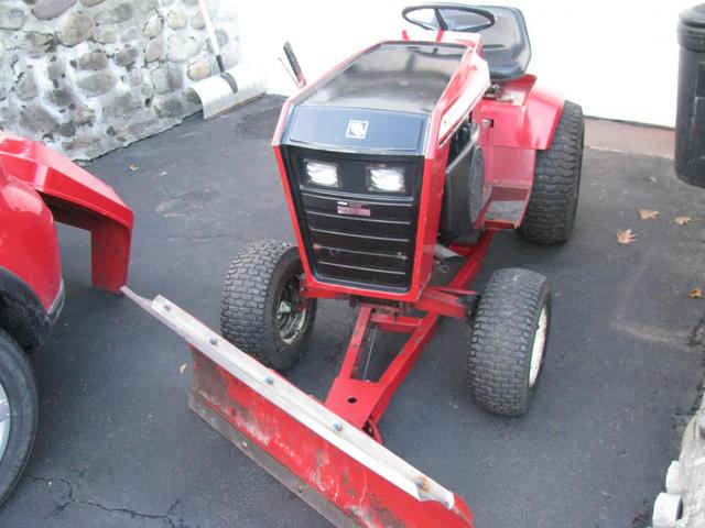

AMC RULES 37,260 #2 Posted July 30, 2014 My '83's hood has a gloss black. Share this post Link to post Share on other sites
aboutime 9 #3 Posted July 30, 2014 Thanks. Your tractor looks good. I like the fenders. I had to make some for mine. The plastic ones are destroyed. I would post some pictures but I have not figured that out yet. Share this post Link to post Share on other sites
