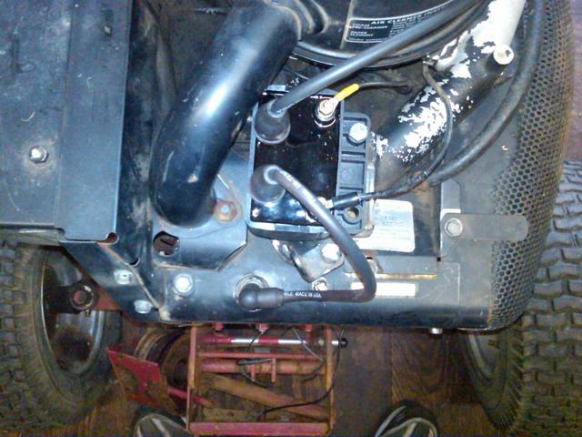

km3h 543 #1 Posted July 27, 2014 (edited) I read somewhere that you can use a Harley Davidson coil on the Kohler twins. I can't seem to find that thread. Is there a special Harley coil that can be used and what modifications will I have to make in order to use it? The coil for a Kohler is about $180.00, give or take a few dollars. Harley coil is less than $100.00. This is for my 416-8. Seems the engine runs well but if you pull the wire for the back cylinder the engine dies. Pull from the front cylinder and it drops RPMs but runes. Now reverse the wires on the coil and it runs on the rear cylinder but not the front. I assume the coil is bad but I will ohm it out tomorrow. Funny thing is that I have spark coming from both sides of the coil. I suspect one side is weak. I did put new plugs in it but haven't pulled them yet to see how they look. again tomorrow I will do that. Edited July 27, 2014 by km3h Share this post Link to post Share on other sites

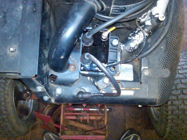

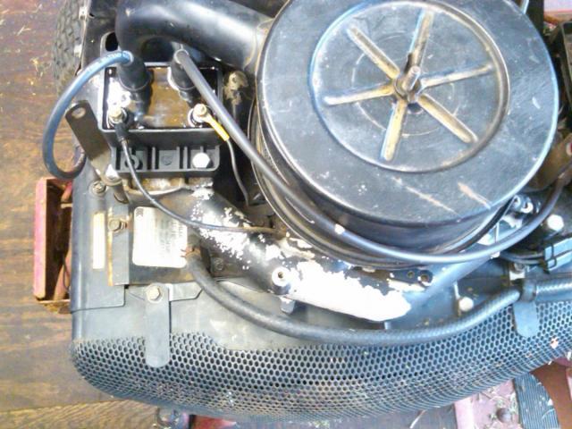

km3h 543 #7 Posted August 9, 2014 Put the Harley Davidson coil in today and cut grass. Tractor always runs better on two cylinders. Not sure if I will leave it there or not. Hard to find suitable spot to mount it. I will most likely fabricate a bracket for it later. 1 Share this post Link to post Share on other sites
