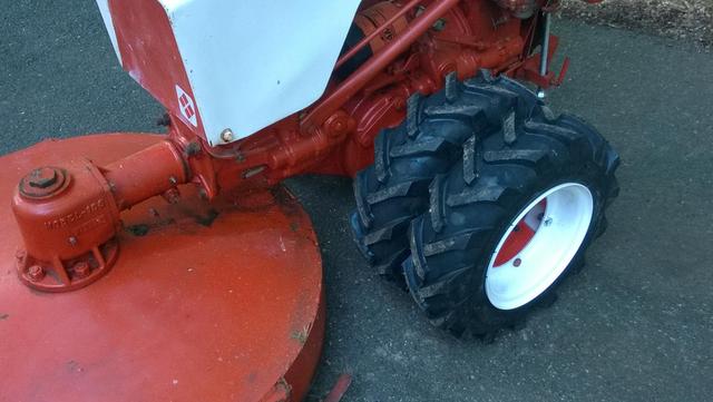

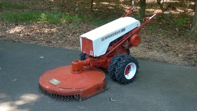

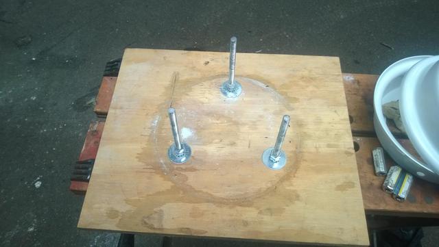

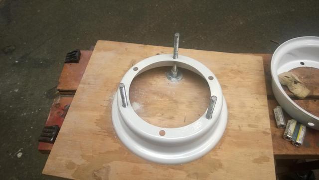

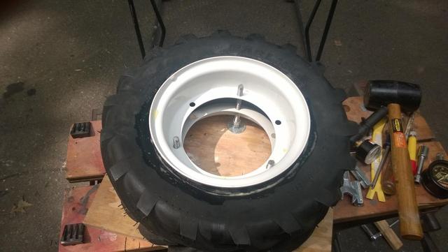

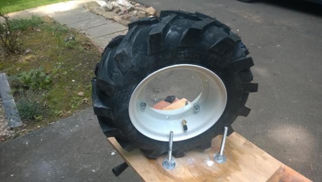

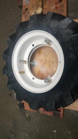

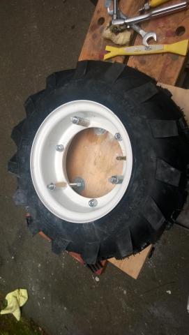

shallowwatersailor 3,221 #1 Posted July 27, 2014 Here is a series of photos showing how I mounted three pairs of new tires on new rims for my Gravely Walk-Behind tractors. Instead of using screwdrivers, etc., to align the rims, I made a jig using 3/8"-16 threaded rod, 3/8"-16 coupler nuts, and 3/8"-16 T-Nuts to hold them in-place. Apply a liberal amount of talcum powder to the tube and inside of the tire. Use Ruglyde to lubricate the bead and rim. With this arrangement I mounted four 4.80-8 and two 16X6.50-8 tires in about two hours. It went quicker with each one. You do need to be careful not to pinch the tube though which is probably the most time consuming part. 7 Share this post Link to post Share on other sites

shallowwatersailor 3,221 #3 Posted July 27, 2014 New shoes look great John... can't wait to see some new video of it in action. Hopefully the duals help with traction because with singles it was slipping on the slope. Having the duals on it makes it a lot harder to push by hand! I'm building my upper body strength. 1 Share this post Link to post Share on other sites

tunahead72 2,633 #5 Posted September 18, 2014 Hey John, Thanks for this cool tip! I bought an old heavy duty wheelbarrow at an auction a few years ago for $5, and now have to install a new tire on the old split rim. I've been scratching my head for a while thinking about how to do it exactly, looks like your method will work very nicely. Thanks again! Share this post Link to post Share on other sites
shallowwatersailor 3,221 #6 Posted September 18, 2014 Hey John, Thanks for this cool tip! I bought an old heavy duty wheelbarrow at an auction a few years ago for $5, and now have to install a new tire on the old split rim. I've been scratching my head for a while thinking about how to do it exactly, looks like your method will work very nicely. Thanks again! Ed, I did another pair after the first three sets. I actually enjoy doing it! John Share this post Link to post Share on other sites
