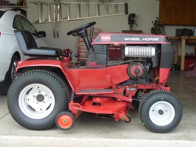

ScottR 5 #1 Posted July 27, 2014 Good morning, Does anyone know of a source of a larger diameter front rim that would fit a 312-8 (1995)? I really want more deck height. I can only get the deck to about 3 1/4 cutting height which makes my horse only good for cutting the weed field becasue we like to keep the yard at about 4 1/2 to 5" in the summer. My rear tires stand 23" at 12 PSI which gives me over 3 3/4' on the back but makes it impossible to get the variance in the front and rear ends of the blades within 1/4". I thought taller from tires would be a good solution. Thanks all. Scott Share this post Link to post Share on other sites

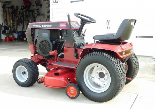

ScottR 5 #22 Posted October 5, 2014 I finally installed the 8" rims from Zieg after having them powder coated and installing 4-ply Carlisle turf saver tires. I also installed 7" red deck wheels. This set up gives me 4" blade height so I can mow my yard with it during the dry months. I also bit the bullet and installed a new Toro muffler and heat shield. We'll see how my faux stainless paint holds up on the heat shield. 1 Share this post Link to post Share on other sites
JC 1965 1,547 #23 Posted October 6, 2014 I finally installed the 8" rims from Zieg after having them powder coated and installing 4-ply Carlisle turf saver tires. I also installed 7" red deck wheels. This set up gives me 4" blade height so I can mow my yard with it during the dry months. I also bit the bullet and installed a new Toro muffler and heat shield. We'll see how my faux stainless paint holds up on the heat shield. Where did you get the 7" deck wkeels ? Share this post Link to post Share on other sites
ScottR 5 #24 Posted October 6, 2014 They are Arnold all purpose wheels; not really designed for deck wheels but they should last for a couple of years. I got them at Fleet Farm in MN but noticed yesterday that my local Tractor Supply also has them. Share this post Link to post Share on other sites
