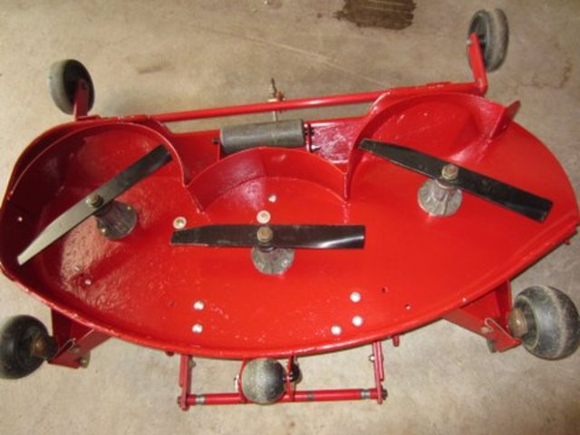

D Block 2 #1 Posted July 24, 2014 Does anyone have an underside pic of a 42" SD deck? Just bought one for my 310 and the grass is clumping. There are no deflectors under the deck. Looks like they we're cut out at some point. Thinking I need to bend some up and tack them in to properly throw the grass out of the side chute. Thanks!! Share this post Link to post Share on other sites

doc724 925 #6 Posted July 25, 2014 Two possible causes. 1. You need high lift blades (low lift blades are for rear discharge). 2. The cutting edge needs to be closest to the ground. No disrespect, but the blades will cut if you install them upside down-I and many others have done it. There are no baffles on newer 42 inch SD decks. My 42 inch deck is on the tractor now, however, here is a pix of a 48 inch one. They are identical except for size. Share this post Link to post Share on other sites
