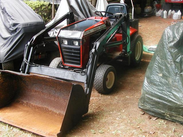

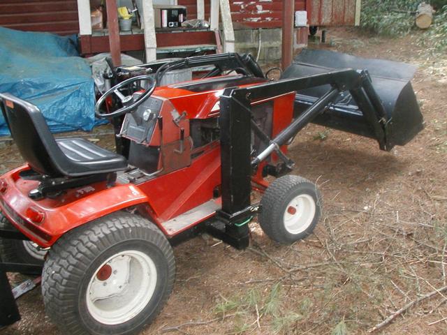

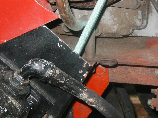

JackC 619 #1 Posted July 22, 2014 I have been curious about having a tractor with a loader on it. I decided that what I really wanted was a four wheel drive unit with a loader so I passed on a number of Wheel Horse tractors with loaders. Then, this Kwik-Way loader showed up on eBay and not too far from me. I bid on it and won the auction for $869.03. I figured I could find out how well they work without having to lay out a lot more money. I have a 1997 520H with the heavy duty swept front axle and gear reduction steering that it will eventually go on. In the mean time I mounted it one of my C-175 Automatics just to see if it even worked. Well it does work and it is a nice set up. Things I ran into are the following. 1. The tolerances are very tight and a little extra paint made it hard to install. I had to scrape some excess paint off to get the front loader support piece to fit into the front tachmatic unit. The tight fit is a good thing since there will be no slop when using the loader. The fit to the tractor is excellent and the weigh box attaches to the rear of the loader frame under the tractor. 2. The pump belt runs very close to the PTO harp and I had to use a bungee cord to keep it from rubbing. I may be able adjust the pump to get a little more clearance. 3. The top hinge points are worn but that is not a problem for now. I may have the holes redone over the winter. 4. The pistons all leak down a little but not bad enough to interfere with getting some serious work done. 5. The traction of the rear turf tires and the lack of differential lock did give me some problems backing up a small incline with a load in the bucket. 6. The steering is not the easiest with the standard C-175 front end. The 520H with gear reduction should be much better. If I were to do it again I would pay more for a unit in a little better condition. It also has a lousy paint job on it. Now that I have this loader I will use it and hold out for a four wheel drive unit at a later date. Here are some pics. 3 Share this post Link to post Share on other sites

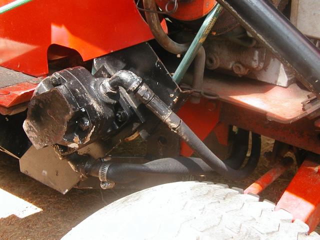

JackC 619 #8 Posted July 22, 2014 (edited) On those loaders is the pump ran off the pto or is there some other setup for it? Sent from my iPhone using Tapatalk The pump mounts on a plate on the loader frame that mounts under the tractor. The pump is driven by a 30 inch V belt that runs off the PTO. The fluid reservoir is in the left side upright on the left side of the tractor. It takes about a gallon or more of Automatic Transmission Fluid to fill the reservoir. The pump runs off the PTO. Fluid is in the left side upright. Edited July 22, 2014 by JackC Share this post Link to post Share on other sites

Wheel Horse Fan 3 #11 Posted July 24, 2014 (edited) The pump runs off the PTO. P7200799.JPG You return line is collapsed or twisted, not sure if you caught that or not. That's a great price for the loader. I would've taken it and ran. The gear reduction steering definitely helps, but it can still be a bit hard to turn with a full bucket. Edited July 24, 2014 by Wheel Horse Fan Share this post Link to post Share on other sites
JackC 619 #12 Posted July 24, 2014 Wheel Horse Fan, Yes, thanks, i was aware of the return line being twisted. The loader seemed to work fine with it like that. I do plan on draining the fluid out and replacing it since there may be some water or moisture in it and I also will be replacing that return line. Share this post Link to post Share on other sites
