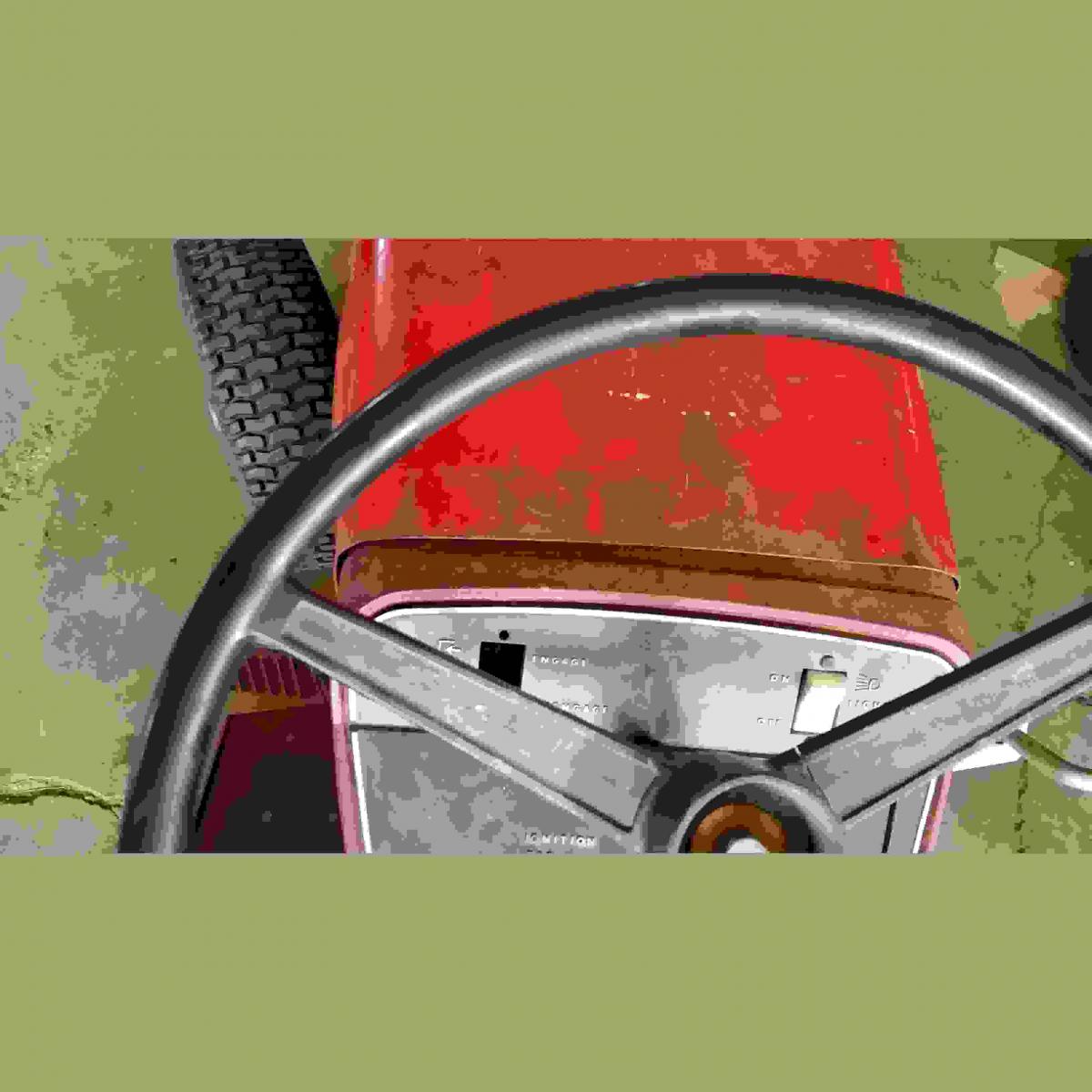

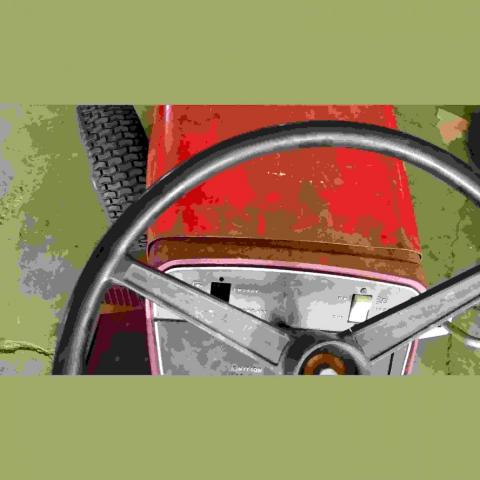

jeremi3210 752 #1 Posted July 20, 2014 Hello I just picked up a gt14 and where the hood and the dash meet it is miss aligned by about a 1/4 inch or so. Is there a way to adjust this? I tried to post a pic but it says the file is to big. Share this post Link to post Share on other sites

Brrly1 1,146 #4 Posted July 20, 2014 (edited) It might be where you tighten fuel tank mount and check the front grille piece,it might needs adjusting? Only an idea, but would be a place to start. I have to imagine the tower is tight so thats where I would begin, those are the 4 bolts you need to check Edited July 20, 2014 by Brrly1 Share this post Link to post Share on other sites
jeremi3210 752 #5 Posted July 20, 2014 Brrly1 I did check all the tower bolt and they are all tight looking at it it does appear that the tower or dash is twisted. Share this post Link to post Share on other sites
Martin 2,134 #6 Posted July 20, 2014 these are similar to the 953/1054. the dash tower part of the frame might be twisted, but you might have the same problem i had with the grill. where the grill sits on the frame i needed to space up a corner or two to get everything to line up. you will find that holding the spacers in place will be a pain, so once you work out what you need, tape them in place before resting the grill down on the frame and bolting it. you can spend some time getting the grill/hood/dash lined up properly, but its the only way to get them looking good. Share this post Link to post Share on other sites
