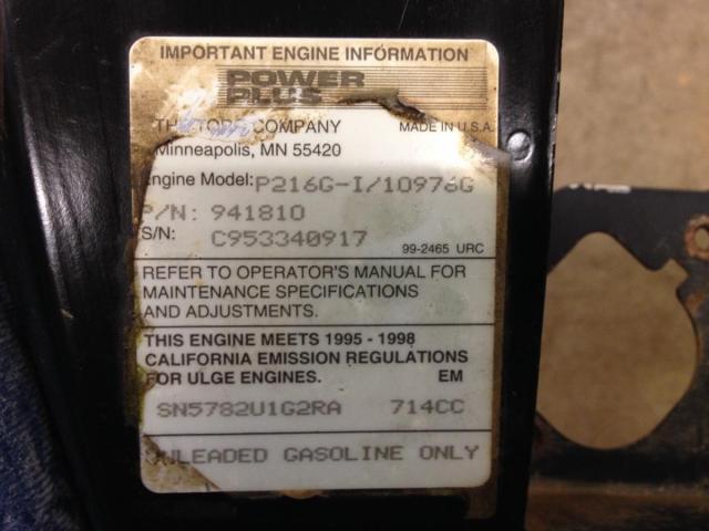

spec g is when the emission carbs were introduced. if you look at the engine tag it has a spec number, something like.....
P216G-I/10976G . spec G
P216G-I/10976D . spec D
the 520 engine would have P220 instead of P216
they changed the id tag layout to reflect the 1995-1998 California Emission regs.
heres a spec G tag
