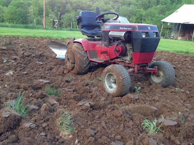

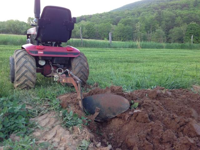

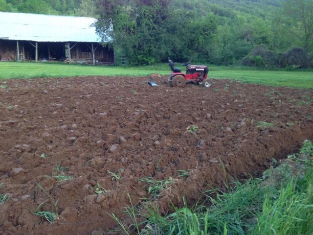

leeave96 496 #11 Posted July 23, 2014 I have a 314-8 and a 520H that I plow with. Both are GREAT - but, since I put Matt's foot control kit on my 520H, it is an easier tractor to plow with. Here's why: The foot control frees up your right hand to use on the steering wheel, you can twist and look back without having a hand on the hydro lever. Makes plowing much easier. Also with the foot control kit, you can slow down when starting to spin and then resume speed once traction is gained - all while looking over your shoulder at the plow and wheels - NICE! The other advantage to the 520H is the hydro lift. My plow is a 12 inch Brinley and it is heavy! The hydro lift snaps it up like it's nothing. Last spring I ran this combo hard in my garden and it worked like a champ! Nothing sounds better than a smooth running Onan getting into the governor on a hard pull! I don't know that I'd plow with an Eaton 700 unless the ground is just real sandy and then I'd think twice. Here are a few pics of plowing last Spring. Good luck, Bill Share this post Link to post Share on other sites
