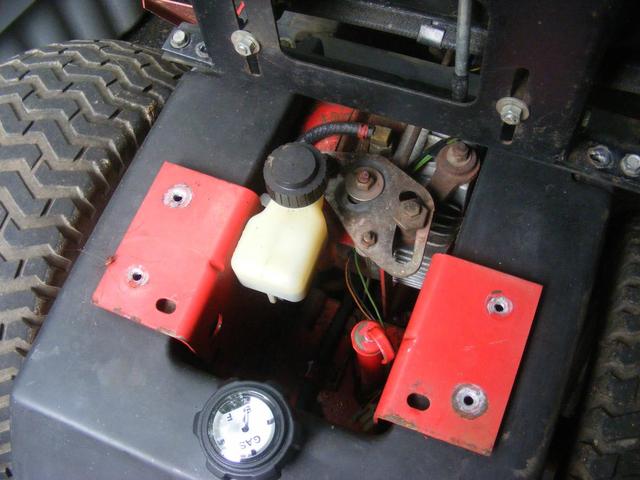

shallowwatersailor 3,222 #3 Posted July 14, 2014 Some Tractor Supply stores carry 20W in gallon jugs. Later Lubrication charts recommend 30W for the transmission which is the plastic reservoir. The transaxle use 10W-30 motor oil and is checked with the dipstick. Share this post Link to post Share on other sites
