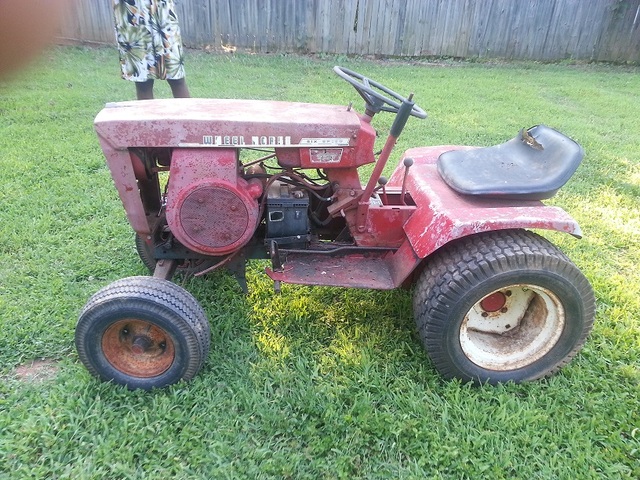

humnbass 0 #5 Posted July 14, 2014 Wow! I thank you guys for your replies. I'm glad I posted because I had ruled out a broken rod thinking that if it was I would hear some noise (rattling, knocking or something) when I turned the motor. Worst case scenario would be that I would have to rebuild the engine. I'm mechancally savvy to a point. I have built performance VW aircooled engines so how hard and how expensive would it be to rebuild the engine. Also, is it worth me doing so or should I just cut my losses. here are some pics Share this post Link to post Share on other sites

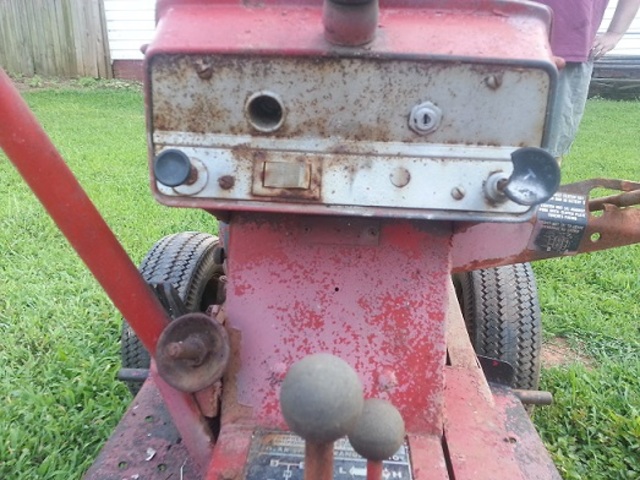

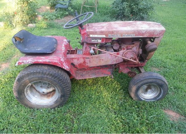

humnbass 0 #11 Posted July 15, 2014 Well Guys, I'm torn as to what to do about this tractor. What do you guys think would be a fair price for it? Here are a couple additional pictures. It's not running which means I have no idea if the tranny is good but I kinda like it. However, I don't want my judgement to be clouded either where I regret it later. I'm leaning towards not getting it (I'm kinda stalling). I just want to be sure that I'm not passing on something that I should have just bitten the bullet and got it. I definitely won't pay more than $150 for it under no circumstances. thanks again Share this post Link to post Share on other sites

humnbass 0 #14 Posted July 16, 2014 Well Guys, I got the Raider 12. Now I must find out all of the unknowns: Does it run, is the tranny good, what is that lever on the left for? How to install the belts etc. The price was just right. Yes!!!! Share this post Link to post Share on other sites
Catmanii 36 #15 Posted July 16, 2014 Lever on the left raises and lowers the deck. Download a manual for it and take the plug out to see if the piston is moving up and down - or not. Share this post Link to post Share on other sites
