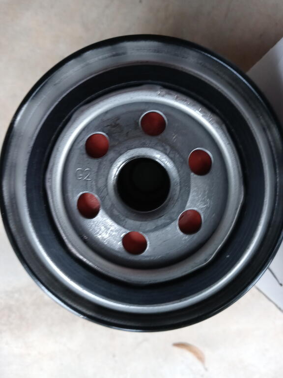

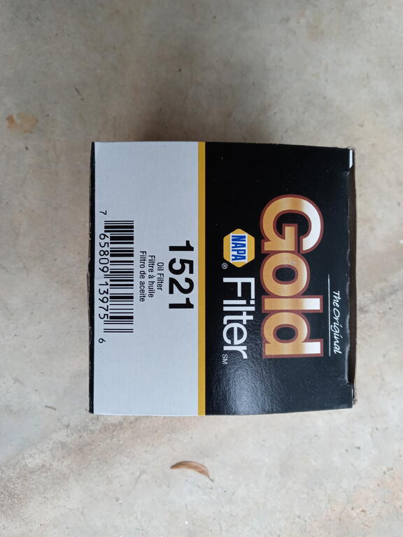

Horse Newbie 7,405 #28 Posted October 9, 2020 5 hours ago, bcgold said: IMO if you followed the manufactures maintenance schedule for filter replacements it wouldn't matter which brand of filter you used as long as the numbers cross over. I routinely cut filters open to inspect for metal particles magnetic and non magnetic types. Shiny chrome specs possible bearings, brass would be bushings or thrust washers or piston slippers, black particles in moderation could be considered normal wear. 4 hours ago, bottjernat1 said: Doing regular maintenance yes its true if you do regular maintenance that's good. But I will tell you first hand a filter is not just a filter. The cheap ones can cause damage over time specially on how cheap they are made. I used frame ones on my 01 dakota for years well the last 5 years i had all sorts of engine issues and i did regular oil changes and did what ever the truck needed when it needed it. Wished i would have used a wix or some like it. So it does matter. you buy cheap you get what you get I bought the NAPA Gold 1521 cross referenced from the factory part number. Thr guy at NAPA said it was rated at 21 micro s which somebody on here said would work fine. My concern of question is the red I see down in the holes on the filter. Do you guys think that may be a type of check valve or something(you know like some oil filters have) that may cause damage to an Eaton 1100 hydro ?O can take it back and get the WIX 51410 or NAPA 1410...what say you ? Share this post Link to post Share on other sites
squonk 48,066 #29 Posted October 9, 2020 Yes. Take it back and get a 1410. 1521 is an engine oil filter. 2 1 Share this post Link to post Share on other sites
953 nut 69,133 #30 Posted October 9, 2020 33 minutes ago, Horse Newbie said: I bought the NAPA Gold 1521 cross referenced from the factory part number. Take it back, it is an automotive engine oil filter! Princi Wix 51521 & Napa 1521 Oil Filter 51521 Retail Price: $10.99 Price per filter: $6.36 Availability: Filter in Stock Discounts Save 10% for $125 order: $5.73 Save 20% for $200 order: $5.09 Quantities Filters per Case: 12 Filters sold single or by the case ple Application: Principle Application: Alfa-Romeo (86-93), Nissan Cars (67-89), Porsche (70-76), VW (71-83), Bobcat, Case, David Brown, Doosan, Ford, J.C.B., Komatsu, New Holland Tractors, Nissan, Toyota Forklifts SIGN UP FOR FRIENDS OF FLEETFILTER! Share this post Link to post Share on other sites
Horse Newbie 7,405 #31 Posted October 9, 2020 17 minutes ago, squonk said: Yes. Take it back and get a 1410. 1521 is an engine oil filter. Thanks guys for the information...this is why I come here first before I do anything to my 520H. You fellas can save me a lot of heartaches. I'm just basically going through the tractor, cleaning it up, and trying to get the engine running with fresh oil, filter, fuel system clean up...that way when I get it going I can check some issues I had when I bought it about 3 yrs ago. 2 Share this post Link to post Share on other sites

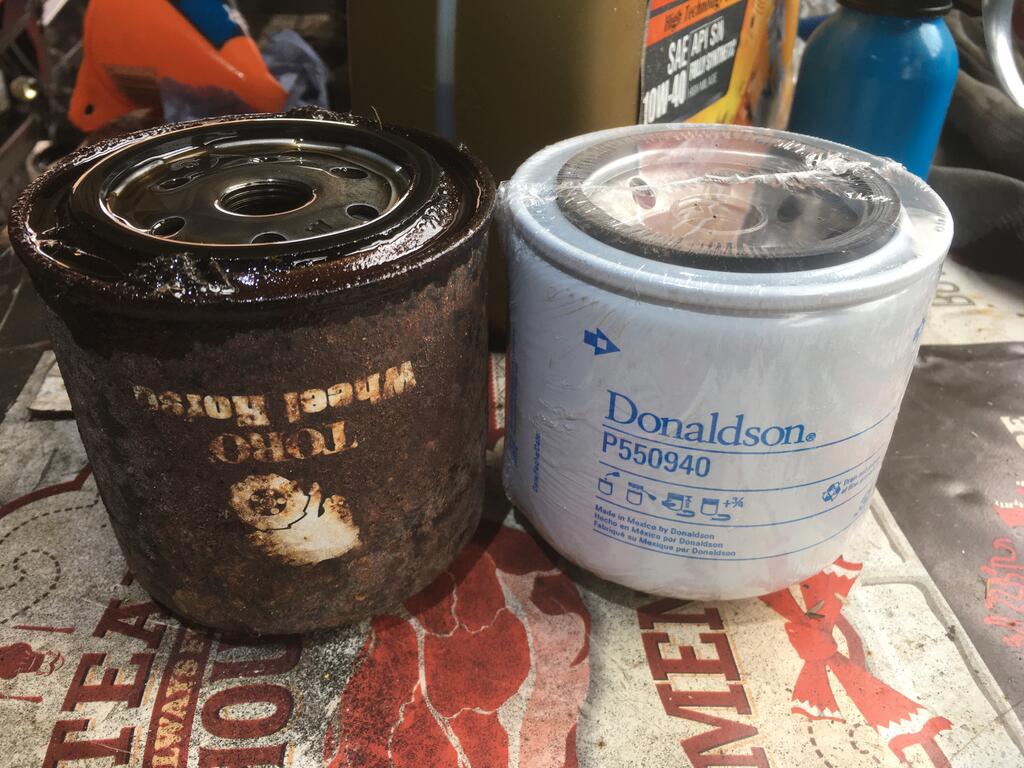

Armadyllo 12 #32 Posted January 31, 2022 (edited) If anyone is still curious about what's inside a Toro Wheel Horse xi transmission oil filter - here are some details. Edited January 31, 2022 by Armadyllo 1 Share this post Link to post Share on other sites

Armadyllo 12 #35 Posted March 24, 2024 (edited) I know there is always pressure and encouragement to buy the original part because it's the best, it's tested, you want to take care of your machines etc. etc. but on the other hand we know there are other options at least equally good and some parts really aren't available on some markets. In the UK the original filters from Toro cost around £27 which to me it seems quite pricey. Napa 1410 is not very easy to find either. My father is using Donaldson P550940 for at least 5 years now and after hundreds of hours of use he never had any issues. I can get this filter for less than half the above cost and it's always a good deal when we buy it in pair with the engine filter - Donaldson P550335 [I don't work for Donaldson ]. Edited March 24, 2024 by Armadyllo 3 Share this post Link to post Share on other sites

Armadyllo 12 #38 Posted March 25, 2024 Donaldson says their filter P550940 is rated at 17 micron. Stens 120-265 which is shown on eBay as an alternative to Toro 79-5270 is rated at 16 micron. Another option from Hydro-Gear which is also an alternative to Toro, rated at 16 micron. I am not sure what's the micron rating of the original part from Toro. Share this post Link to post Share on other sites
WHX?? 58,053 #39 Posted March 25, 2024 Donaldsons are supposed to be good filters. My big tractor had them throughout OEM. Trouble is not many local place around here have them. Only place was the dealer and they enjoy quite a margin on them. Wonder if they are rebranded? Share this post Link to post Share on other sites
squonk 48,066 #40 Posted March 25, 2024 Dodnaldson is a good filter. I can tell you the difference between Napa Gold and what they call "Pro Select is a couple of less pleats and sometimes the color of the shell. That's it. Share this post Link to post Share on other sites
