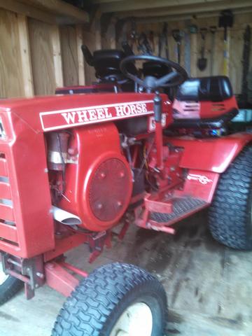

The battery is not charging on my 75 C-120. I changed the regulator and cleaned the connections. The ampere meter is showing no charge. I have this multitester, but have no idea how to use it. Could someone walk me through how to test the electrical system,. Key switch, regulator, Stator and Battery?

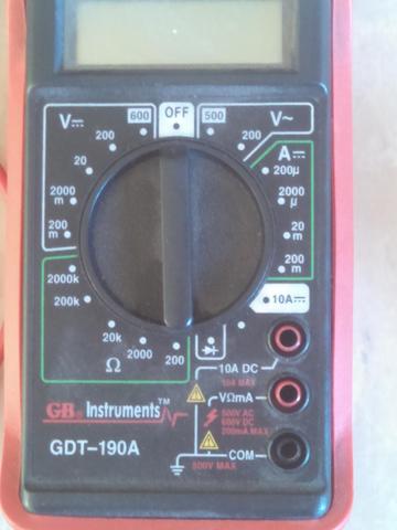

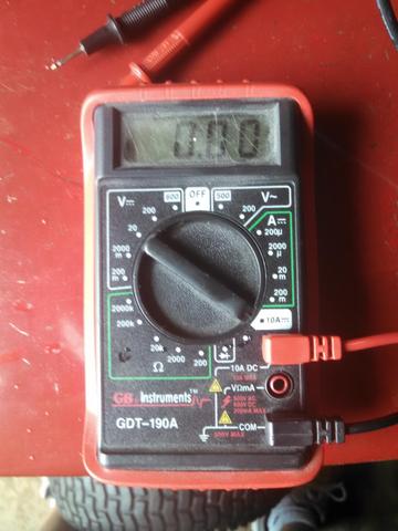

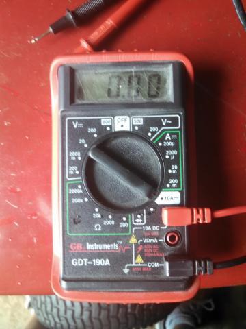

Do I unhook the battery terminals? Is this the correct setting on the multimeter?

I put the MM on V 20 and the battery reads 12.77. So the battery is good. What's next?
608KEB

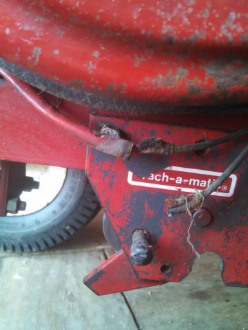

I think I found the problem. I'm not sure if the stator works. My multitester 9v battery went dead. Could someone tell me what to set my multitester to. for checking if the stator is charging. I also accidently touched the 2 stator wires together and it sparked. I'm guessing the stator must be working.

Glad you found the problem. FYI, to use the multimeter to check amps the leads need to be connected in series with the circuit. It looks like that meter is 10 amps max so you could damage it depending on what the charge rate is. Checking voltages as Bob M mentioned will be fine.

28.5 VAC coming from the stator at 1/2 throttle. I soldered and heat shrunk tubed the new connections. Tractor is charging like it should! Thanks guys!!
