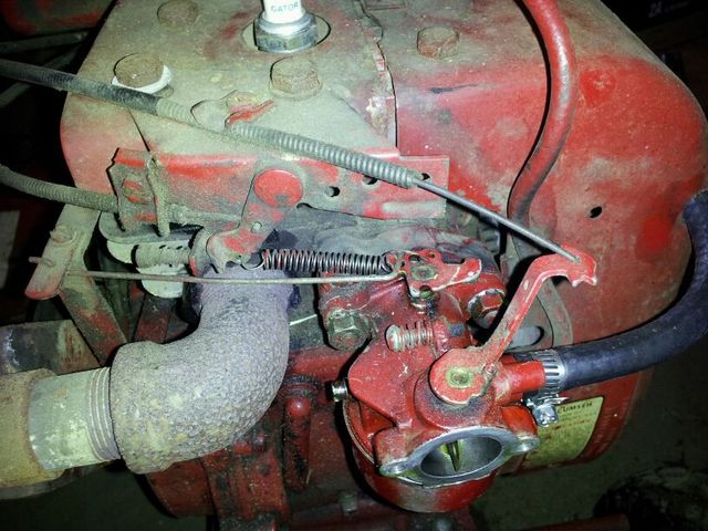

kirk37r 0 #1 Posted July 8, 2014 Hello, This forum was suggested to me. I have A Tecumseh OHH 60 6HP engine that I cannot figure the Governor Spring setup on. They are off the engine and I dont want to run it till I get them on. Hoping someone might have one of these and can lend some assistance. I have been to Tecumseh website and all over the web and cant find A diagram. Any help is greatly appreciated. Thank You Share this post Link to post Share on other sites
JustinW.73 224 #2 Posted July 8, 2014 Did you look around for an owners manual? It would have it on that. Could you take a picture of it and also send a model and serial number if possible. Share this post Link to post Share on other sites
roscoemi 245 #3 Posted July 8, 2014 Is this what it looks like? Share this post Link to post Share on other sites
JustinW.73 224 #4 Posted July 8, 2014 Yes. I have an engine very similar to this. Yes that looks correct. Just make sure you know whats wide open and idle. The way you have it in the picture is wide open and there is a little screw right by the arm that connects to the throttle cable. Share this post Link to post Share on other sites
