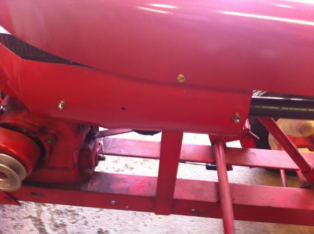

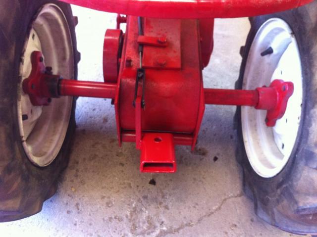

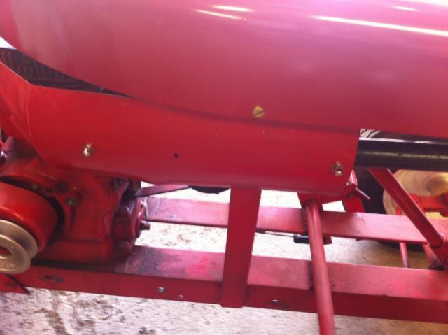

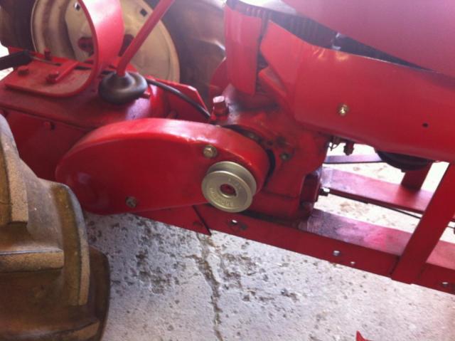

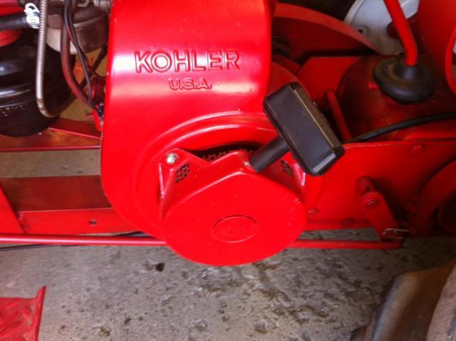

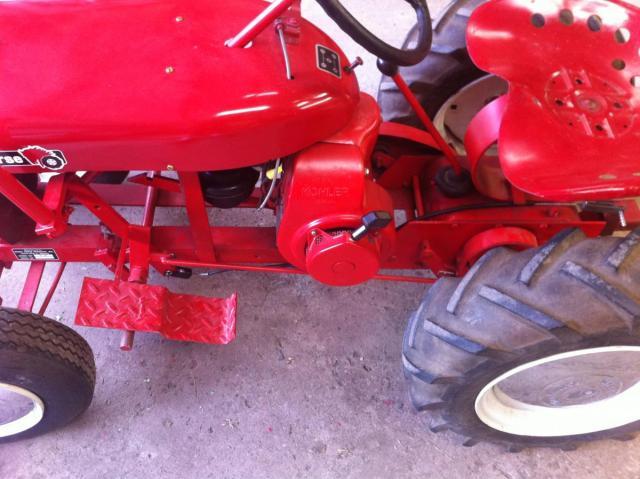

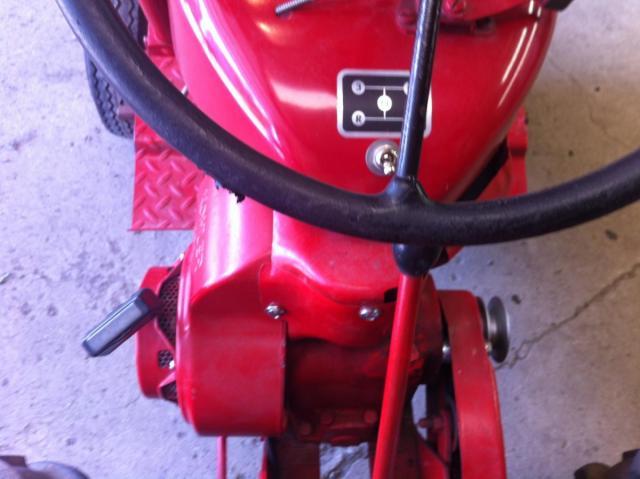

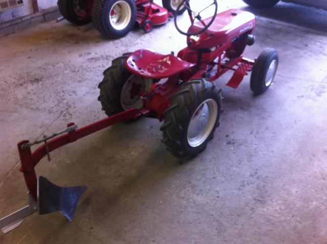

squonk 48,322 #1 Posted July 5, 2014 Started working on the RJ I got at the show. (Who doesn't like working on show tractors?) Haven't done a lot to it "since" I got it home. It needed the correct hitch (had a full size tractor hitch held on with a 5/16" bolt) no lift linkage, red overspray all over ect. I only drove it during the parade. It was noisy when letting out the clutch but at the show there is so much noise it was hard to pinpoint. Rigged up a hitch and cable with a collection of parts I got from J-Dog and used a 5/16" brake line for conduit. REmove the plastic on/off switch that was half red and installed a nice toggle as well as got rid of the yellow wire nut. Replaced the wrong spark plug and crappy plug wire end. Added some stainless hardware for some eye appeal. I was worried about the trans. It rattled like gears grinding when letting out the clutch. So I drained the old gear oil. It was black but no water or metal shavings. filled it with a 50/50 mix of 90 and diesel. And took it for a ride. Drained the oil and replaced it as well as changed the engine oil as well. I hear the rattle in the belt guard so I need to look into that but the trans sounds fine. Also the exhaust loosened up and getting it tight enough put the muffler into the gas tank. Looks like a conduit nut is in order there Pics and video. I didn't think about the video until I was halfway into it. I managed a shot of a burned out house that's being torn down plus a quick look at the new Horse Hauler Tundra 9 Share this post Link to post Share on other sites

squonk 48,322 #4 Posted July 5, 2014 (edited) Just need to finish that exhaust and find that rattle. I VHT'd the muffler and am getting a lock nut tomorrow and then a general de-gunking. Lots of oil film all over the frame. Then a nice seat cover from Jo and I'll call it good! Edited July 5, 2014 by squonk Share this post Link to post Share on other sites

squonk 48,322 #9 Posted July 6, 2014 (edited) Yuppers, just add a nice front axle weight. Are you going to put any attachments on it other than the plow, front blade possibly? Just a plow for shows.(I have another of these plows all restored) and a tub cart with matching hubcaps.Like to get fenders and a tool box someday. Edited July 6, 2014 by squonk Share this post Link to post Share on other sites

stevasaurus 23,884 #16 Posted July 6, 2014 (edited) Looking good Mike...your seat spring is on backwards. HA...made ya look. Edited July 6, 2014 by stevasaurus 1 Share this post Link to post Share on other sites
squonk 48,322 #17 Posted July 6, 2014 (edited) It WAS on backwards when I got it. First thing I fixed! (sense) Edited July 6, 2014 by squonk 1 Share this post Link to post Share on other sites
