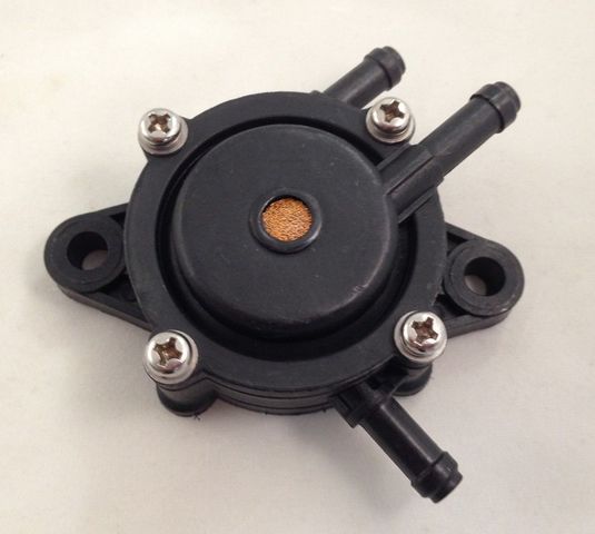

u170293 0 #1 Posted July 2, 2014 Well, the D200 wont start, it sparks and will chug if you add fuel to the carb. I checked the fuel pump and its not moving any fuel. This is one of the vacuum type pumps, I verified that the vacuum line works, and it is leak free. Can I just replace this with any vacuum type pump? I see a bunch on Amazon and ebay that seem like they could work..... I included a picture of one Any recommendations are appreciated! Share this post Link to post Share on other sites
Desko 684 #2 Posted July 2, 2014 Yea it should work just might not bolt up. We have a Briggs fuel pump on my dads D160 as the onan one went bad. Share this post Link to post Share on other sites
