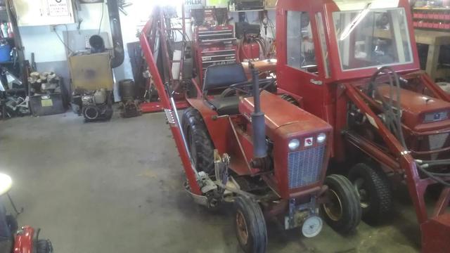

jeremi3210 759 #4 Posted July 2, 2014 My 953 is one of my favorite tractors I have. I've modified mine a little with a 8 speed 8pinion trans. 2 Share this post Link to post Share on other sites
