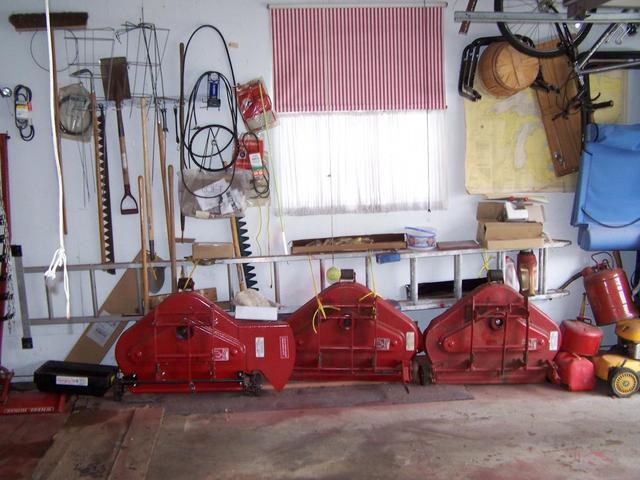

Lane Ranger 12,150 #3 Posted July 2, 2014 (edited) Yopu can still pick up good 36 inch decks for $50 to $150 at swap meets , yeard sales and online. The quality always varies but you already know what a good one looks and operates like. I have three back up decks -just in case! I never want to have to rebuild one before mowing! Edited July 2, 2014 by Lane Ranger Share this post Link to post Share on other sites
