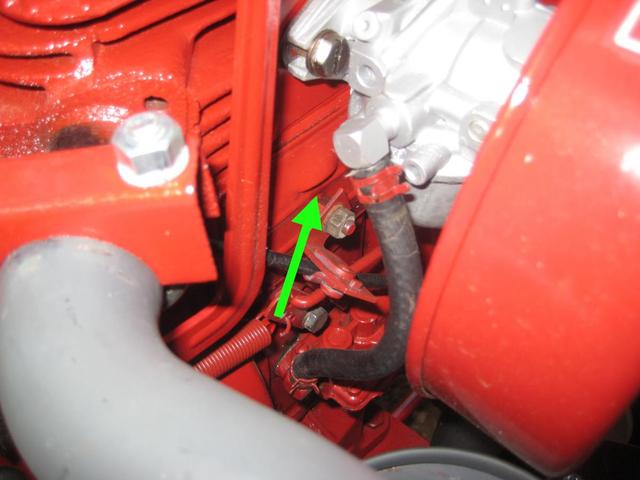

wheelhorse66 10 #1 Posted July 1, 2014 My k301 is leaking oil from around were the governed is attached to the engine.how can I fix this? Share this post Link to post Share on other sites
WH nut 553 #2 Posted July 1, 2014 Check your breather to make sure its not plug and make sure its not over full of oil Share this post Link to post Share on other sites
wheelhorse66 10 #3 Posted July 1, 2014 (edited) Do you mean the air breather on the carb? And its just barely over the full mark. Edited July 1, 2014 by wheelhorse66 Share this post Link to post Share on other sites
rmaynard 17,443 #4 Posted July 1, 2014 Typically, there is no way to seal the governor. However, under normal circumstance there should be no reason for oil to be coming out at that spot. As mentioned above, check your breather to be sure the drain hole is not plugged, and that the plate with the reed valve is installed correctly. A blocked breather will cause oil to come out in the most unusual places. The carburetor has to be removed to check the breather, so while you have the breather off, it might be a good time to check your valve clearances. If you have oil coming out of the governor hole, you probably have oil coming out around the points as well. If you need a Kohler manual, you can download one from the manuals section. 1 Share this post Link to post Share on other sites
wheelhorse66 10 #5 Posted July 1, 2014 It won't let me download the manual but were is the breather located? Share this post Link to post Share on other sites
rmaynard 17,443 #6 Posted July 2, 2014 Underneath the carburetor. email me at rmaynard@qis.net and I will send you a pdf manual. Share this post Link to post Share on other sites
