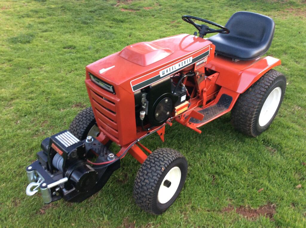

McGrew 461 #13 Posted December 1, 2020 This Raider 10 (now 14) is priceless... Dad bought it new in Sept. 1971, and it was his favorite tool. He loved working in the garden! Danny 2 Share this post Link to post Share on other sites
