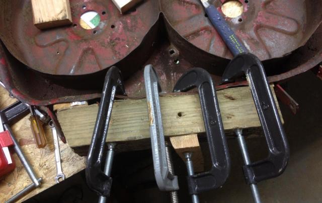

Racinbob 13,113 #15 Posted June 24, 2014 A lot of feasible ideas here and I'll add one more that has worked for me a few times. I would cut a 2x4 (yellow pine is tougher) to fit snug between the two roller brackets. Then use a couple of large C-clamps and start pulling it out, moving the clamps as needed. Basically the same idea as doc724 but without drilling holes. I think you'll be able to get the worst of it then just fine tune from there. Maybe when you get close space the 2x4 out with a couple small 1x2's at the ends so you can pull far it enough. It will probably want to spring back a fuzz. 2 Share this post Link to post Share on other sites
Ed Kennell 47,036 #16 Posted June 24, 2014 (edited) Drill 3 holes in the damaged area. Flip the deck on its back and bolt the deck down to a solid surface. Use several of the holes already there to fix it solid. Get a piece of 3x3 angle iron and drill three holes in it to match the three you drilled earlier into the deck. Bolt the angle iron to the same solid work surface as the deck and line up the holes as good as possible. Put 3/8 or 1/2 inch threaded rod thru the 3 deck holes and the angle iron, add nuts and maybe a backer place inside the deck and tighten the nuts. Go slow alternating the nuts. Think of this as the poor mans hydraulic jack. With patience you should be able to get it pretty close to straight. Ditto on the 3X3 angle as a strongback to pull it back into shape. Use 6-8 deep C clamps to pull it to the angle. Some of the bolt holes will move out of position as you get the deck edge pulled close to the angle . Use blocks under the ends of the angle so you can over stress it to the correct shape as it will spring back. Edited June 25, 2014 by ekennell 1 Share this post Link to post Share on other sites

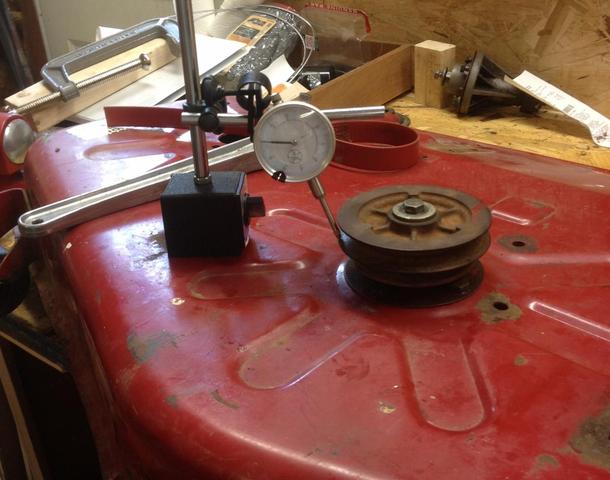

persof 14 #17 Posted June 27, 2014 (edited) Progress so far. I have to figure out how to correct the LH side so that the roller will be straight. Edited June 27, 2014 by persof 1 Share this post Link to post Share on other sites
Racinbob 13,113 #18 Posted June 27, 2014 Once you get the deck straight you may not have a whole lot to do on that roller bracket. Take a couple of small pieces of wood and sandwich the arms with one of those big clamps. Then you will be able to ease it straight with it bending at the factory bend and not messing up the arms of the bracket. You're getting close Share this post Link to post Share on other sites

Ed Kennell 47,036 #20 Posted June 28, 2014 Lookin Good. Can you lag bolt the roller bracket to the 4X4 as you have it positioned now. Then take out the spacer block and pull that section in where the block is now ? Share this post Link to post Share on other sites

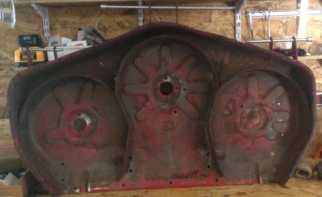

persof 14 #21 Posted June 29, 2014 Ready to re-assemble. 1 Share this post Link to post Share on other sites
Desko 686 #22 Posted June 29, 2014 Wow that turned out nice given its previous state. Great job! Share this post Link to post Share on other sites
AMC RULES 37,259 #23 Posted June 29, 2014 Virtually can't even tell... very nicely done. Share this post Link to post Share on other sites
Ed Kennell 47,036 #24 Posted June 29, 2014 Another great save ! Share this post Link to post Share on other sites
cheesegrader 436 #25 Posted June 29, 2014 (edited) Impressive! If you ever pass through the U.P., I have a couple of decks that I would like to show you.... Edited June 29, 2014 by cheesegrader Share this post Link to post Share on other sites
