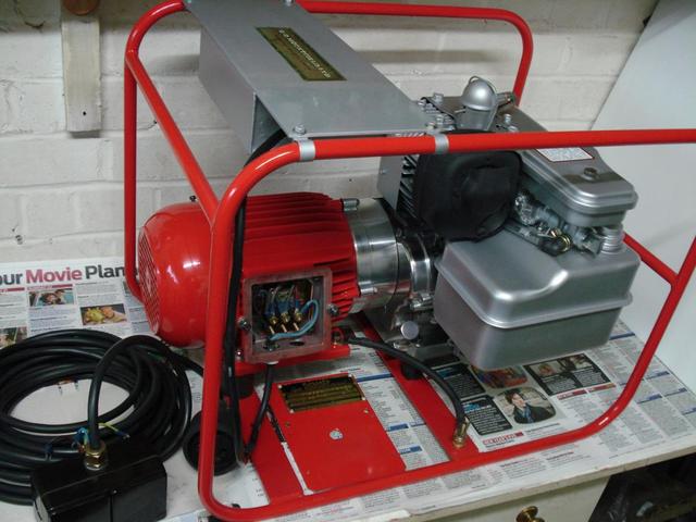

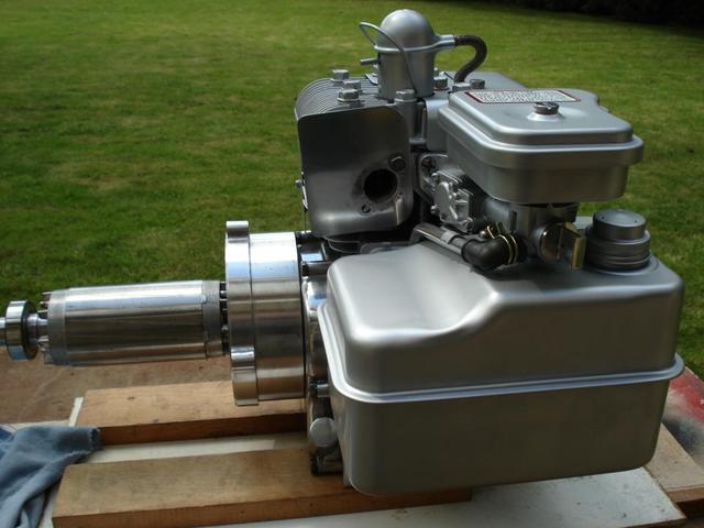

Anglo Traction 761 #6 Posted June 23, 2014 look's like you'll have much more luck than me with a Genny. I thought I could save and repair one to fit on one of my tractors, but had no through-bolt like you have or Bearing support at the engine end. Also had doubts of a tapered Crank connection, rather a threaded end. had to leave it and put it back as a Genset .... a few pics of it- refurbed Engine- Defeated and back as a Genset- Hope you have a good outcome. Share this post Link to post Share on other sites

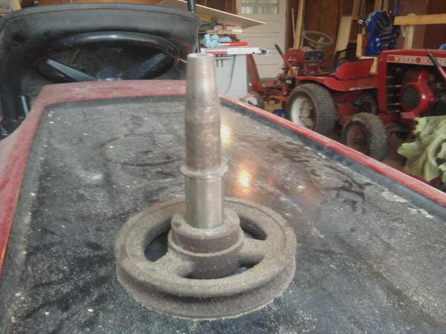

WH nut 553 #13 Posted June 26, 2014 Here is what it looks like with just the pulley installed 2 Share this post Link to post Share on other sites

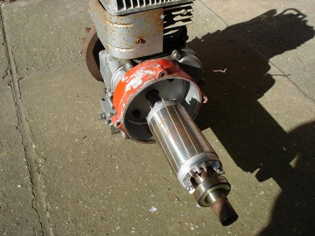

Racinbob 13,047 #15 Posted June 30, 2014 (edited) You're right shorts. I figured it utilized the engine bearing on that end. I did finally get the rotor to break free (the stator is the stationary windings around the rotor) and there's not much to work with. I was hoping that I would have enough of the crankshaft to allow it to be milled into a shaft for the generator. No such luck but I just had to see. I'm probably going to reassemble the generator head and sell it to someone who has an engine. There's also several excellent parts on the Techy so I'll part it out. I could kick myself. I had a 5kw Wheel Horse branded generator when we lived up north. It went with all the other stuff when we moved here. Edited June 30, 2014 by Racinbob Share this post Link to post Share on other sites
