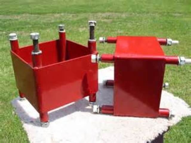

whtractors24 3,565 #17 Posted June 25, 2014 Well I wanted to put duallys on the 704 and carlisle stopped making super lug in 6-12 I got lucky and found a pair now my question is what do you guys do to like the thread up to each other. Share this post Link to post Share on other sites
Racinbob 13,040 #18 Posted June 25, 2014 There's several different styles of brackets for mounting duals. Here's one. Share this post Link to post Share on other sites
whtractors24 3,565 #19 Posted June 25, 2014 I got the ring from miller tire I just have to figure out easiest way to line up threads on the duals if you know what I mean. Share this post Link to post Share on other sites
Racinbob 13,040 #20 Posted June 25, 2014 I don't know what style you have but the type pictured bolts into the outer four square holed in the rims. Bolt it on to the wheels mounted on the tractor and then slip the outer wheels on. Are yours a different style? Share this post Link to post Share on other sites
Pullstart 70,705 #21 Posted June 26, 2014 I got the ring from miller tire I just have to figure out easiest way to line up threads on the duals if you know what I mean. don't bead up the outer tires until you mount the wheels? maybe you'll be able to spin them to match the treads up Share this post Link to post Share on other sites
