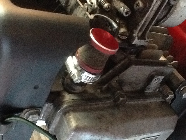

Jparkes43 329 #3 Posted June 18, 2014 (edited) I removed my crankcase breather amd allowed it to vent it to the atmosphere not only does it allow for your problem to be emitted it gives a bit more power amd runs smoother and cleaner. Attached is a pic if this may be an option of you James Or you could run a line to an oil catch can away from the engine and then regularly empty the catch can but it is up to you Edited June 18, 2014 by Jparkes43 Share this post Link to post Share on other sites

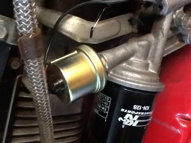

Racinbob 12,996 #4 Posted June 18, 2014 Thanks SK. I sure hope it's not wear because this motor has less than 200 hours on it and I've been anal about maintenance. I don't know much about Commands either but it sounds to me like you might be on to something with the reed valve. Do you know if the reed valve sticking could cause a drop in oil pressure? The reason I ask is that recently I would start her up to mow the yard. The oil light went out quickly as normal. But after mowing I would shut it down for a few minutes to blow it off then restart to put it in the barn. That hot restart would cause the oil light to go out quickly like normal but then it would come back on for a couple seconds before it flickered out again. I hate idiot lights and am thinking about putting a mechanical pressure gauge on it. Share this post Link to post Share on other sites
Racinbob 12,996 #5 Posted June 18, 2014 Thanks for the pic. That's an idea but since this started suddenly I'd like to find the issue. I don't mind it trying to reburn the oil as long as things are normal. Share this post Link to post Share on other sites

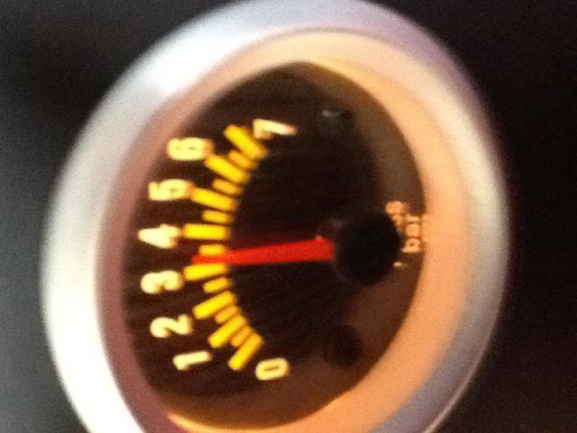

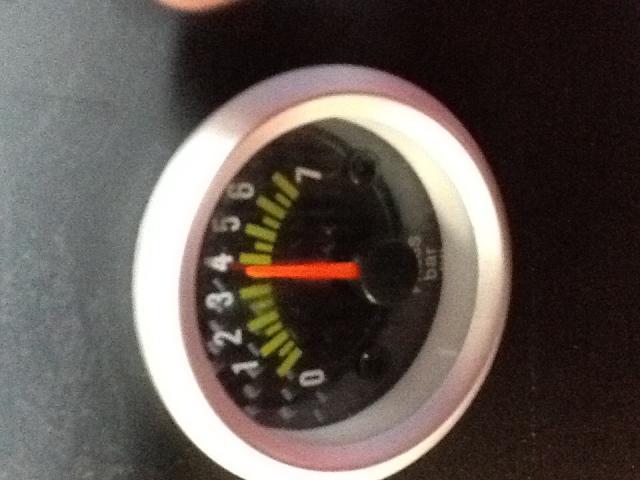

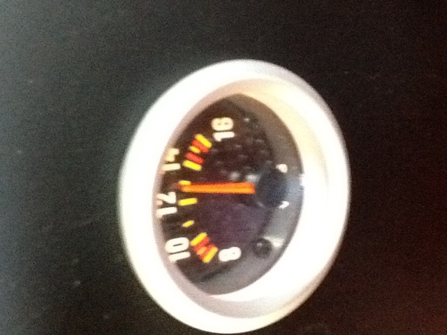

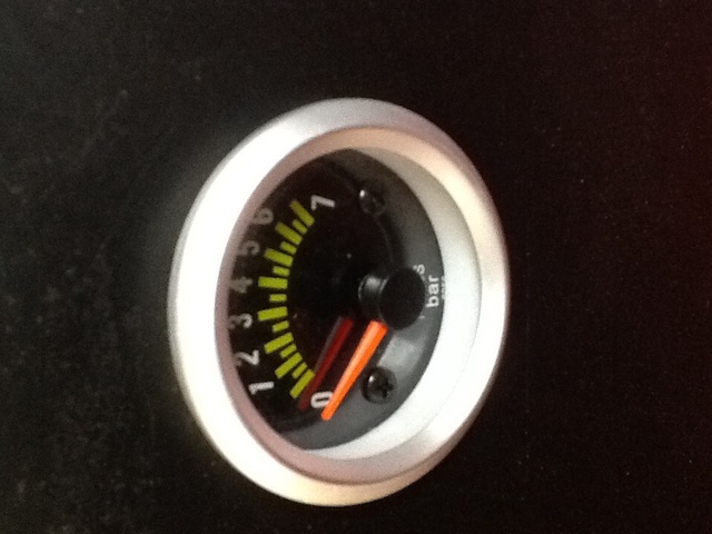

Jparkes43 329 #6 Posted June 18, 2014 (edited) I have a mechanical oil pressure gauge and It is very nice, I replaced it for the exact same reason as you.. James Thanks for the pic. That's an idea but since this started suddenly I'd like to find the issue. I don't mind it trying to reburn the oil as long as things are normal. Glad I could help. Edited June 18, 2014 by Jparkes43 Share this post Link to post Share on other sites
Racinbob 12,996 #7 Posted June 18, 2014 I like that. Now you know exactly what's going on with the pressure. I'm going to find one that comes as close to matching the voltmeter as I can. Share this post Link to post Share on other sites

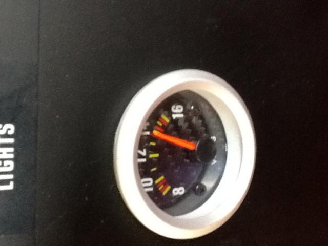

Jparkes43 329 #8 Posted June 18, 2014 (edited) I like that. Now you know exactly what's going on with the pressure. I'm going to find one that comes as close to matching the voltmeter as I can.Here's is my one I used, you can also buy a volt gauge from here so it will be a matching pair you don't have to buy them all James http://www.ebay.co.uk/itm/2-52mm-Car-LED-Boost-Water-Oil-Temperature-Oil-Pressure-Tachometer-Volt-Gauge-/271275969498?pt=UK_Other_Clothing_Protection&var=&hash=item3f294ecbda This is a good breather filter if you want one James http://www.ebay.co.uk/itm/Universal-12mm-Breather-Filter-ideal-for-Oil-Catch-Tank-Air-Crankcase-Vent-Blue-/360892455795?pt=UK_CarsParts_Vehicles_CarParts_SM&hash=item5406dddb73 And if you want a catch can them this is something of what you need (you can make one yourself) http://www.ebay.co.uk/itm/Polished-Aluminium-Oil-Catch-Tank-with-Breather-/301212105416?pt=UK_CarsParts_Vehicles_CarParts_SM&hash=item4621a3fac8 Hope I could help James Edited June 18, 2014 by Jparkes43 Share this post Link to post Share on other sites

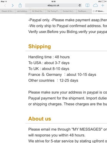

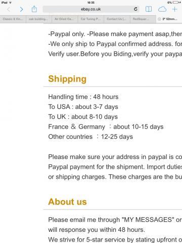

Racinbob 12,996 #9 Posted June 18, 2014 Thanks, I like those. I am a stickler about things matching. He's out of stock on everything but the voltmeter right now. He also doesn't show that he ships to this side of the pond. I'm looking at my options in the Summit catalog now and I'm going to check a couple of stores tomorrow. I also want to put a tee in the setup so the idiot light will still work. Share this post Link to post Share on other sites
Jparkes43 329 #10 Posted June 18, 2014 (edited) Thanks, I like those. I am a stickler about things matching. He's out of stock on everything but the voltmeter right now. He also doesn't show that he ships to this side of the pond. I'm looking at my options in the Summit catalog now and I'm going to check a couple of stores tomorrow. I also want to put a tee in the setup so the idiot light will still work.He does ship to America look James But I'm not sure when they get more stock tough Did you like my other suggestions Also they have lights Edited June 18, 2014 by Jparkes43 Share this post Link to post Share on other sites
Racinbob 12,996 #11 Posted June 18, 2014 All good ideas James. Thanks. The seller with the voltmeter, zsjladyshop, didn't show USA in his list of places he'd ship to. I may have missed it. I had to stop working on it for today. Tomorrow or I'm going to take a look at the reed valve and see if there's anything to it. Being a nut for gauges I am going to put one on it. Share this post Link to post Share on other sites
Jparkes43 329 #12 Posted June 18, 2014 All good ideas James. Thanks. The seller with the voltmeter, zsjladyshop, didn't show USA in his list of places he'd ship to. I may have missed it. I had to stop working on it for today. Tomorrow or I'm going to take a look at the reed valve and see if there's anything to it. Being a nut for gauges I am going to put one on it. Ok that's fine, glad I could help, I like gauges myself but I auctautly took of my idiot lights because they were broken and blinked when there was nothing wrong. James Share this post Link to post Share on other sites
