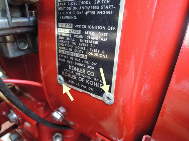

rmaynard 16,838 #1 Posted June 17, 2014 Does anyone know what these are called, and if they are still available? I don't want to use Pop-Rivets or screws. I would like to find originals. Share this post Link to post Share on other sites

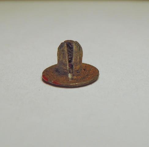

rmaynard 16,838 #4 Posted June 18, 2014 Actually they are not exactly what I want. These do not explode. They have no center pin. The part inserted is already slightly expanded, and holds by spring pressure. Share this post Link to post Share on other sites
Martin 2,133 #5 Posted June 18, 2014 (edited) I think what Bob is looking for is slightly different. You don't use a pop rivet tool to install them. Bob, I found a few of these for mine by stealing from some of my junk engines. They are removable with a tool that pushes the "legs" on the back of them together and they just come out. I just found a very small metal tube to push over the back of them. That's the best way to get the id tags off without damaging them as well. You run the risk of damaging the id plate drilling them I'm not sure where you would buy new, I just cleaned up and replated the originals. Edited June 18, 2014 by Martin Share this post Link to post Share on other sites
rmaynard 16,838 #6 Posted June 18, 2014 That's what I usually do myself. They come out easily with just a push from the inside, then snap back in after you have cleaned or re-plated them. My problem is that I apparently lost two of the little critters in the driveway while disassembling the engine in the fall, and have plowed lots of snow since. I think they have returned to the earth. Hopefully I can find a couple at the show tomorrow. Share this post Link to post Share on other sites

jebbear 386 #8 Posted November 18, 2018 I know this is an old thread, but in the course of my 856 project I found myself in need of one of these engine tag rivets(?) for a Kohler 8 HP. I am missing only ONE and wondering if anyone has a source for these things. Can't seem to find an old Kohler engine shroud locally & wondered if anyone might have some of these laying around? Thanks. Share this post Link to post Share on other sites
