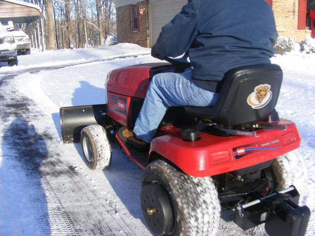

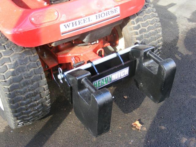

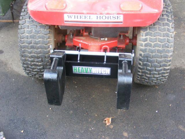

shallowwatersailor 3,216 #26 Posted June 18, 2014 (edited) Here is Tom Rupprecht/Scott Moreau's hitch on my C-105, and 518xi with the Heavy Hitch bracket (he is in Wisconsin) and two suitcase weights. I used this on both the C-105 and 518xi without chains this past winter with out a problem. Edited June 18, 2014 by shallowwatersailor 1 Share this post Link to post Share on other sites

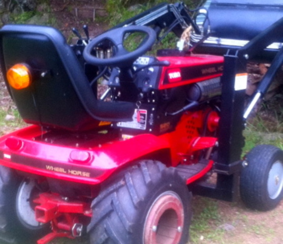

cheesegrader 434 #27 Posted June 18, 2014 Red, I have a weight box on my loader that hooks up to Scott Morneau's 2" receiver. The weight is nice, but the extra length can be hell, especialy if I am trying to work perpendicular to the driveway. Seems like the extra two feet off the rear end really gets in the way. My snow beast is set up with loaded tires, #50 steel weights on the outside of the rims, and #33 pound Berens weights on the inside of the rims. All the weight is on the ground, not the axle, and I don't add any extra length hanging off the back to ding my barn! Next year, I should have the #400 hard-shell Kozy Kab on top. I might not even need weights with that monster! Share this post Link to post Share on other sites

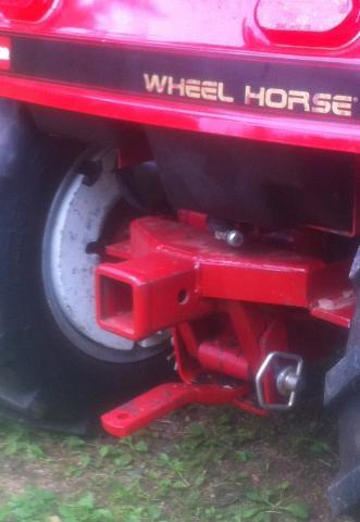

cheesegrader 434 #30 Posted June 18, 2014 Here is the setup on the loader. The snowbeast is currently in pieces in the garage, but will return in time for the first snow in September! The hitch makes it easy to add the weightbox if I need it to balance a heavy load in the bucket (like the Kozy Kab). Most of the time, this works by itself. 266 pounds total weight+load in the tires. The inside weights are 33lbs each, and are shaped like half a bagel. I had to cut a notch for the valve stem I don't think there is a Wheel Horse version, but FMC, Beherns, Bolens, JD, and a few others make them. Share this post Link to post Share on other sites
