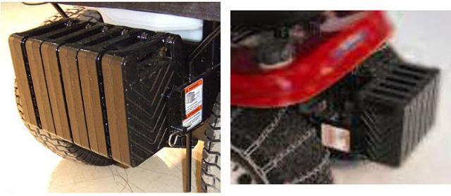

P3x 60 #2 Posted June 16, 2014 Hi Red, I was looking for the same and lucked into a used Berco Rear Counter Wt setup for Wheelhorse tractors. It mounts on the lower tranny attachment fitting. I think they may still be available for WH. Sears sells them and may be able to get them for a 520. Here's a picture from the Sears site: Nice setup. Good luck. p3x Share this post Link to post Share on other sites

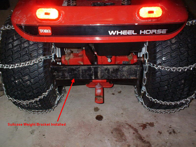

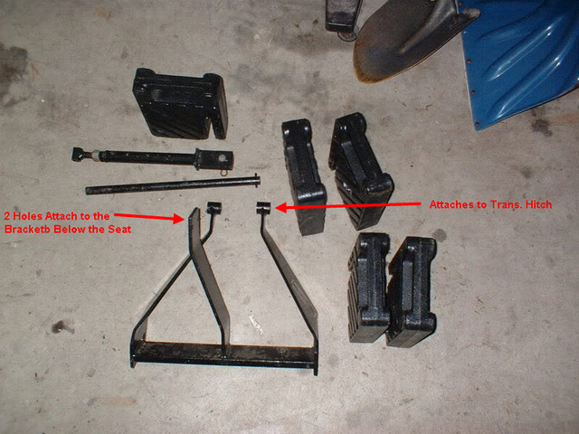

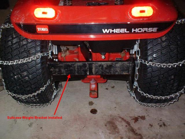

P3x 60 #17 Posted June 17, 2014 Hi Red, Sorry, I was not clear in my response. I do not have pictures of the Berco rear counter weights installed on my tractor. The pictures included from Sears was for example purposes only. The PN on my bracket states it is a W7006KD. I think they may still be available from Bercom under a different PN. I have removed the wts from my tractor and are in off season storage. I culled some info from this site posted by other members to figure out how to install them. I do not have the links but have some pictures (attached). I do not remember the member(s) names who posted them but a Big Thanks to them! p3x Share this post Link to post Share on other sites
